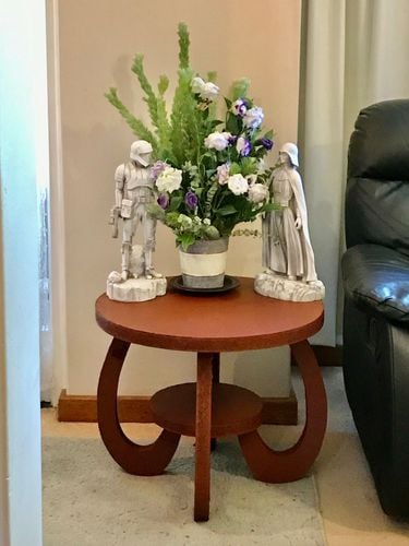

I like Wally’s Walpamur paint, this is the fence paint being used on a table. A large circle and a smaller circle, with legs that look like the letter “G”, to get an Art Deco table.

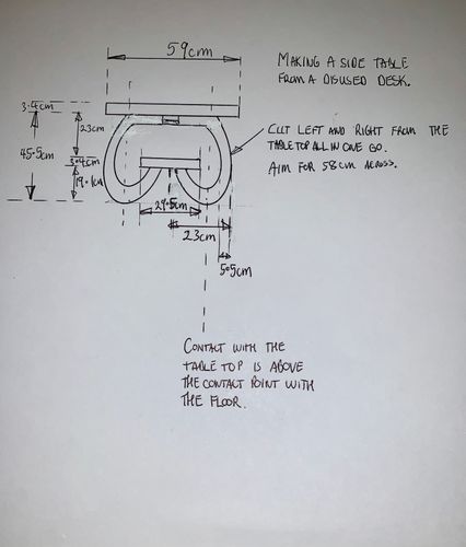

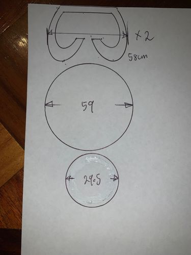

Sizes, the middle is like a housing joint, so the two sides can be held in place. Made from 3.4cm thereabouts desk top.
Note, to make it easier, use the already straight edge of the table, instead of trying to cut another. I found the section when the smaller circle goes was out, so two nursery pots were used as a jig to get the level with the top circle. When using the jig saw to make the circle, don’t look at the blade, look ahead where the notch is at the front of the jig saw. Follow it all the time, if the final is out a mm, who cares.
