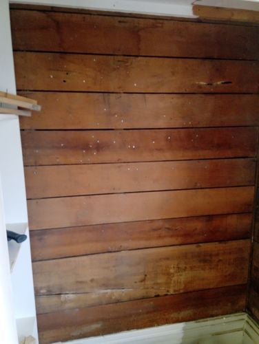

A couple of weeks ago I found that there's still a patch of scrim inside my wardrobe. Most of the house was relined some years ago, but apparently they skipped the wardrobe (it's a circa 50s addition built onto the wall of this 1910 house). Also the only place in the house with the original skirtings so I really should have guessed this!
Neither my insurance nor I are particularly excited about having a fire hazard in the house, so I'm most of the way through removing the scrim, and thinking about what to put in its place. Specifically, getting lost at what options are designed for what!
It's a fairly small area (3m high by 1.5 wide) and it's in the wardrobe so going to be behind clothes most of the time, doesn't need to be perfect. What products would you recommend as a reasonably manageable wall lining material?
(Photo of the sarking that's in place that will be underlying this lining)
