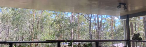

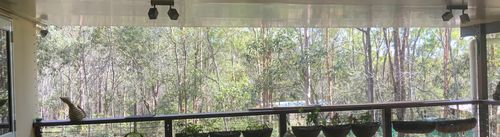

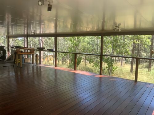

I have a very large back deck constructed of merbau. The deck is 6.5m wide, 13m long, with a 250mm wide bar rail running all the way across. The balustrade is constructed with 90x90mm merbau posts and tensioned wire.
I want to enclose the whole thing with roller blinds made with pawgard (a mesh product designed to keep cats in and snakes and other critters out - see link for product description https://catnets.com.au/collections/paw-guard. I purchased some cheap fly screen blinds (from Bunnings of course), so I could rip these apart and reconstruct my own blinds with the pawgard.

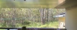

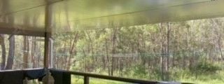

The roof of this deck is made out of colourbond material sandwiched in between polystyrene foam. I am sorry but I don’t know what it is called. This is my first problem. It is not exactly ideal material to bust a couple of screws in to attach anything with any weight really. But on the right and left side of the deck it is the only material I have to work with. The roof also runs on a slight angle which means attaching several lengths of pine directly to it and then attaching the blinds to the pine wont be an option, because the blinds won’t roll up properly.
