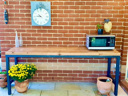

I built another version of my "Computer desk build" post for the outside patio area. We needed a table to replace the old plastic one we were using.

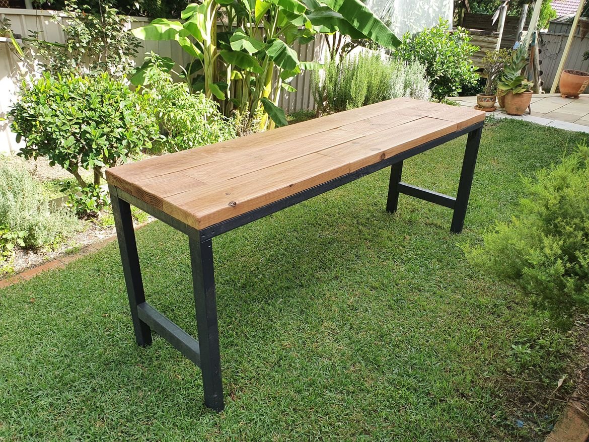

I used the Ironwood Sienna Treated Pine Sleeper (200 x 50mm 2.4m) for the tabletop and just cut it to size with a circular saw. Pieces were joined together using dowel joints and glue. The surface was sanded (80 grit, then 220 grit) , and 3 coats of varnish were applied over a week. Let it dry 24 hrs before the next coat. Final sanding with 220 grit.
It's pretty sturdy, and although not perfect, looks rustic and should last for a long time. It cost around $140-150 for all the raw materials and the table measure are 600mm wide, 2200mm long and 880mm high.

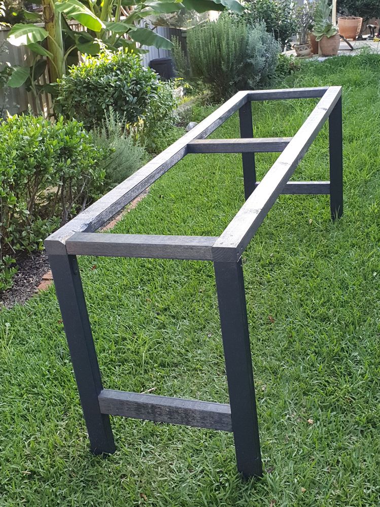

Brackets to add strength
