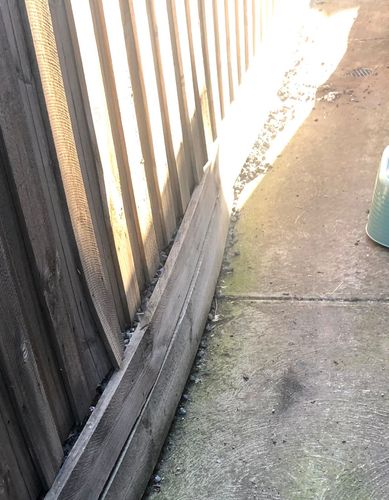

Hello, I’ve just moved into a 10 year old house with a fence line against a car park for a set of units. The horizontal planks on my side looks like they’re about to pop away from the posts due to the force of rocks on the other side. The rocks appear to have been added without any reinforcement on the neighbour’s side. I would love some advice about how best to proceed on my side - ideas so far are to add more planks over horizontal planks; reinforce where they join the posts with heavy duty metal connectors; or it can’t really be saved and so have to replace all horizontal planks and get neighbours to move the stones on other side? Any suggestions appreciated, thanks!
