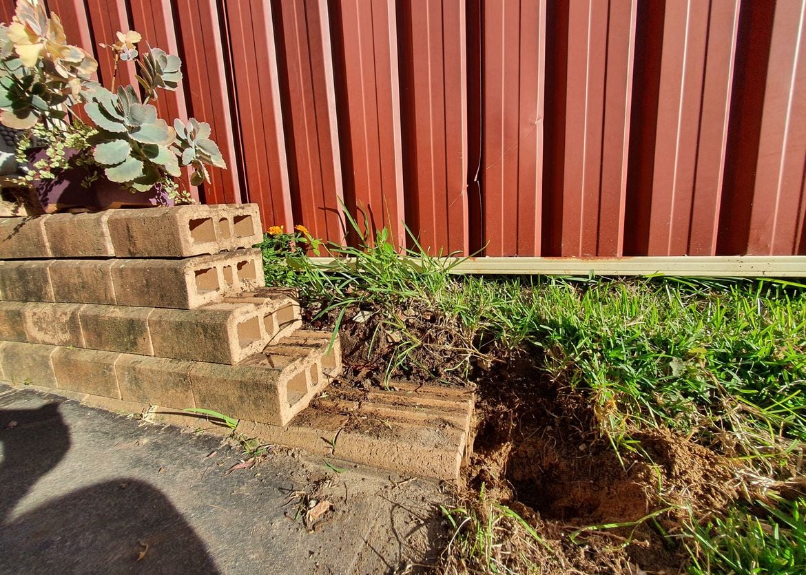

Water runs off from my 2 neighbors into my property causing it to pool in my backyard . I am at the end of a sloping cul-de-sac .
The fence has a gap between itself and the ground ranging between 6 inches to 10 inches.
Last , but not the least , the fence is adjoined ( on my side ) by a row of bricks which consumes space.
I want to "fix" these three things as follows :
- Lay Ag Pipe adjacent to the fence and terminate that pipe on the other side of my property which has a drainage in place already.
- Place H4 timber under the fence to close the gap.
- Remove the bricks
I want to know if someone has been in a similar predicament before and how have the handled it ? Or , if you could tell me any better way of achieving the same outcome or things to look out for ? Thanks so much !!
