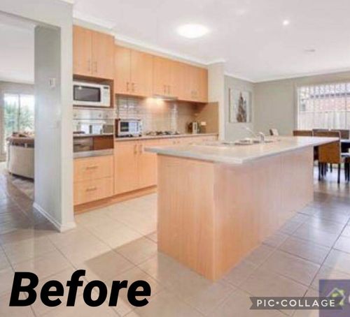

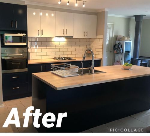

I absolutely hated the timber look laminate and green tiled splash back in our house. so using a few cans of the white knight renew, the hardwood utility panels and white subway tiles I now have a bright, fresh new kitchen.

Bench tops were the most expensive. They are $179 each.
paint was about $200 all up.
tiles were $18ish a box we used 2.
so just under $1000 all up

Brilliant work @NikkiMaree! A true testament of what can be achieved with a bit of D.I.Y. and inspiration. Is that a dark blue you've chosen for the cabinetry? It looks sensational.

Yea it’s a navy blue that is very similar to taubmans colour, admiralty.

I painted them while they were still hanging as I just don’t have the space to paint them while off.
one coat of primer and 2 coats of the top coat.
the paint recommends using a 4mm microfibre roller so that’s what I used, plus a brush for cutting in.

Hey @Cole_73 I really just followed all of the instructions on the can.
basically a really good clean with the white knight tile and laminate cleaner and a good rinse with water. then 1 coat of the primer.
with the top coat laying off all in the one direction. Light sand in between coats as well.

Great work @NikkiMaree What colour white did you use? It looks glossy, is it gloss or satin?
Looks unreal! Well done! May I ask what the benchtops are that you have used? Looking for something similar for our kitchen
@S-A-S-C-H-A
It’s taubmans Milk cloud and it is a gloss finish.
@dinaandjake
Thank you. they are the Hardwood laminated panels 2400x900, my husband cut the narrow one down and cut the holes for sink and stove etc and I’ve done 3 coats of cabots benchtop clear in satin finish.
