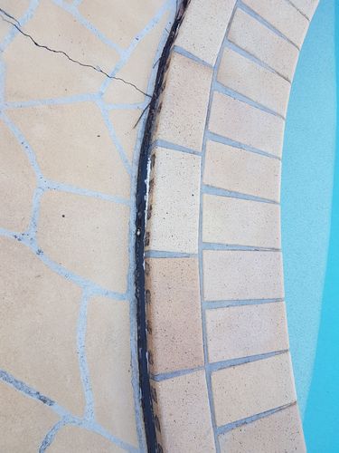

Hi I am just looking at ideas for sealing the gap between pool and concrete, there was previously gap sealer applied but was just looking at maybe a better and products to use

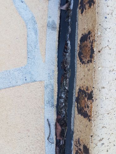

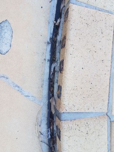

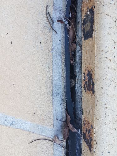

I'd suggest you start by removing as much of the deteriorated sealant as possible with a scraper. You'll also need to remove all the leaf debris from the gap. Using Sika 600ml Black Sikaflex Pro+ Polyurethane Sealant and a Sika Professional Sausage Caulking Gun would be the most economical choice as it appears you'll need a substantial amount of sealant to fill that gap. Once the gap is filled, you can smooth the sealant out for an appealing transition.
The Sikaflex Pro+ does not have quite as good chemical resistant qualities as the Sika pool sealant, though it is likely what they used initially and should last many years. Given the fairly rough nature of the gap, I feel the Sikaflex Pro+ will do a better job at filling the area. The reason the initial sealant has failed is that the gap has enlarged significantly over the years. Sikaflex Pro+ is an elastic sealant, but sometimes the need to re-caulk the joint is unavoidable with this amount of movement.

Hi Mitchell
Please see attached pics, hope they are ok
