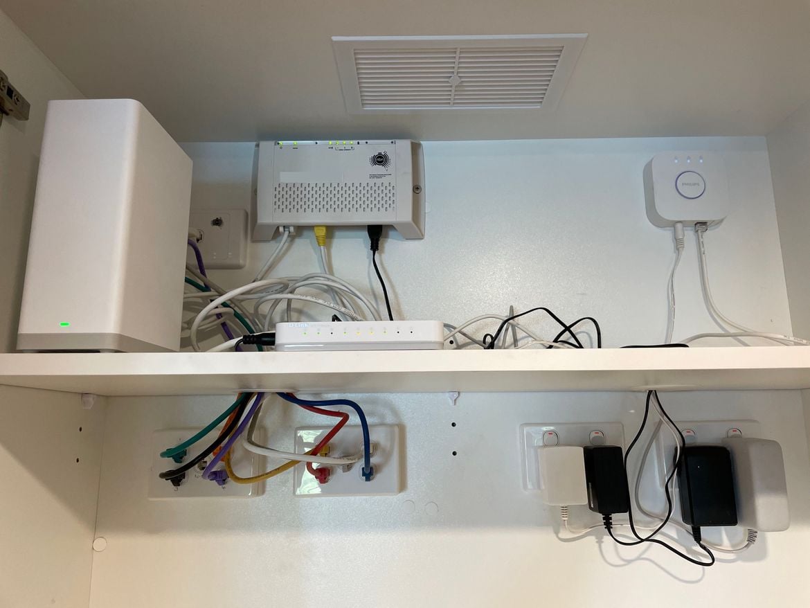

Ideally you need this to all come back to one point so in one of our cupboards I designed the communications hub...
The cupboard was made with extra ventilation in top & bottom for convection cooling.
The wall plates lead to the various outlets and I found a supplier that does ethernet cables in 10 different colours allowing me to colour code at input & outlet side. Much easier than just numbering.
As our modem only has a few outlets I then had to add an ethernet hub or switch.
A bonus of this set-up is out wi-fi range is now much greater as this cupboard is high set and close to the centre of the house.
The Philips box on the right is a Hue hub/bridge for all of our smart lighting and the range of that is much better now too.
Also a heck of a lot neater than having a jumbled mess of cables on top of the fridge as is all too often the case.
