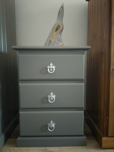

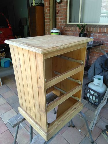

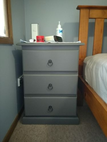

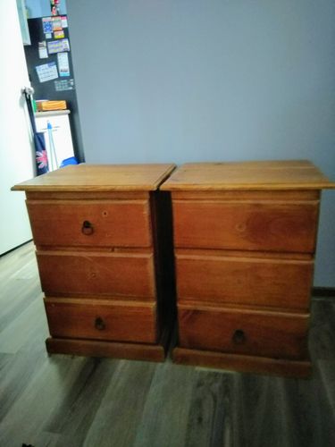

These bedside tables were found on the footpath, missing a few handles and had some slight water damage. I sanded them down with 80 grit sandpaper using a multi tool with sander attachment and a1/3 sheet sander to get the old varnish off. Went back over with 120 grit to finish. Repaired a few dings and split top boards with Earls All Purpose Mul-t-fill, sanding with the 120 grit sandpaper. 2 coats of Zinsser 123 Primer, Stain Blocker and Undercoat, 1 painted with brush then 1 coat with roller and 3 coats of Dulux Aquanamel Dowager Grey. First coat with brush to get into corners etc then 2 coats with roller. One of these is being used as a bedside table (original handles), the other as a mini buffet to store tablecloths, napkins etc in lounge room.(Dorf Drop Round Cross cabinet handles). I already had all of the paint and materials, so total cost was $39.27 for the 3 Dorf handles.
Before
During
Mini Buffet
Bedside Table
