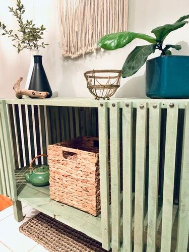

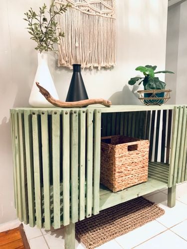

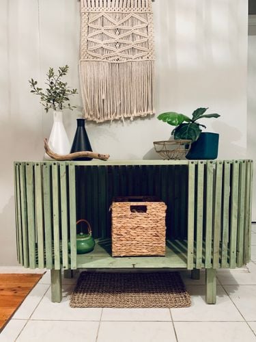

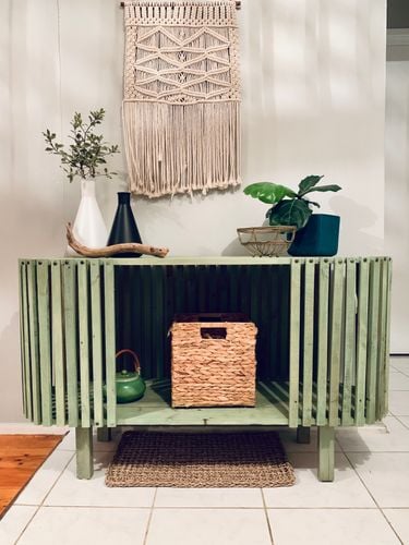

This console unit is made with 100% recycled pallet wood.

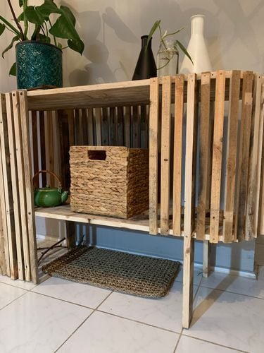

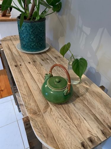

I started with glueing 4 pallet wood timber x 2, together and allowing to dry for 24 hours. This will vary depending on the width of your unit. This will create the console shelves. While this dries, Cut down pallet wood to 25mm strips and sand lightly.
on a piece of paper, I drew the profile for the sides in a oval shape and cut of the ends with a jigsaw. For this self, the space between the two panels was 500mm. The 25mm thin wood was also cut to this size. I used nails to attach the strips to both panels, allowing a 25mm spacing between each strip.
I originally cut the thin strips to meet the bottom but ended up cutting the flush to the panels. I cut 4x 20x40 wood for the legs and marked them and drilled in place. Once this was all nailed together. I gave it a light sand and stained with rustoleum sage wood stain from Bunnings.
