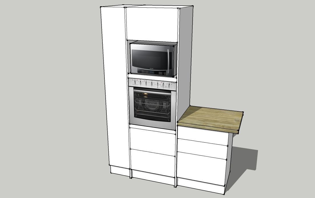

Hello @Jano
Welcome to Bunnings Workshop! You could compromise on your 900mm pantry and have the oven tower placed in that spot and have a small 300mm pantry sandwiched in to the corner. The free space under your cook top can then be turned into another set of drawers. But have a look at the sketch at the bottom and tell us your thoughts and tell me if you wish to see it in another configuration. I hope my suggestions help, if you have any other questions please post it here on workshop.
Cheers,
Red
