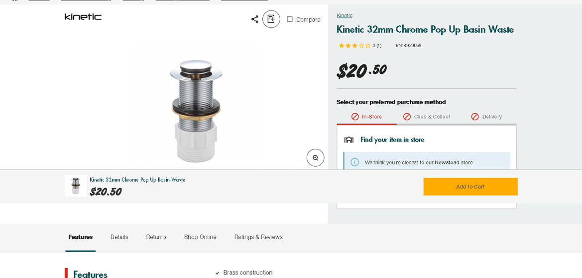

Please let me know if you need any assistance returning the current plug and waste and swapping it for a non-overflow version. This Kinetic 32mm Chrome Pop Up Basin Waste would be a suitable replacement.
Just in case you are wondering what it looks like it is this unit with the 40mm adapter. This pop up waste will fit all the vanity and basins that the store carries.
