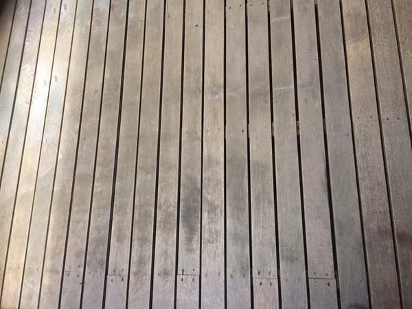

The deck is around 10 years old and looking pretty shabby. The timber is Merbau but I wasn't sure what the original coating put on the deck was - something with a coating that peeled off in parts (as opposed to an oil).
Subsequent oiling never got a brilliant result despite how much I scrubbed and blasted with the pressure cleaner - it was clear that a full sand back to the bare timber was needed.

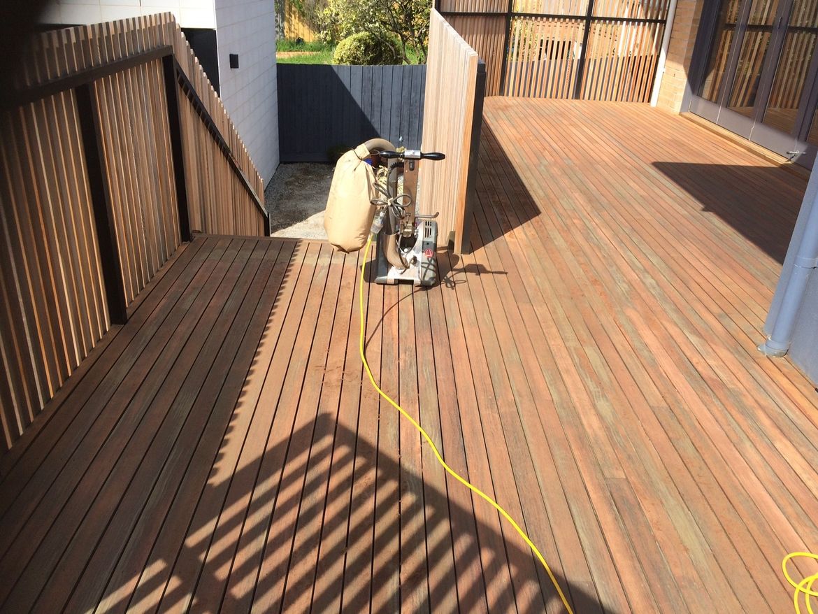

I hired a floor sander for the job. They are heavy beasts but surprisingly easy to use. It's a job anyone can do - even those with limited skills like me! Again I used 40 grit paper for the first sand, then went over again with an 80 grit.
The floor sander is a big heavy machine and a little intimidating. I got confidence from the fact that if I botched it I could always replace some decking boards as they are not expensive! But it really wasn't difficult at all and in no time I could see a vast improvement.

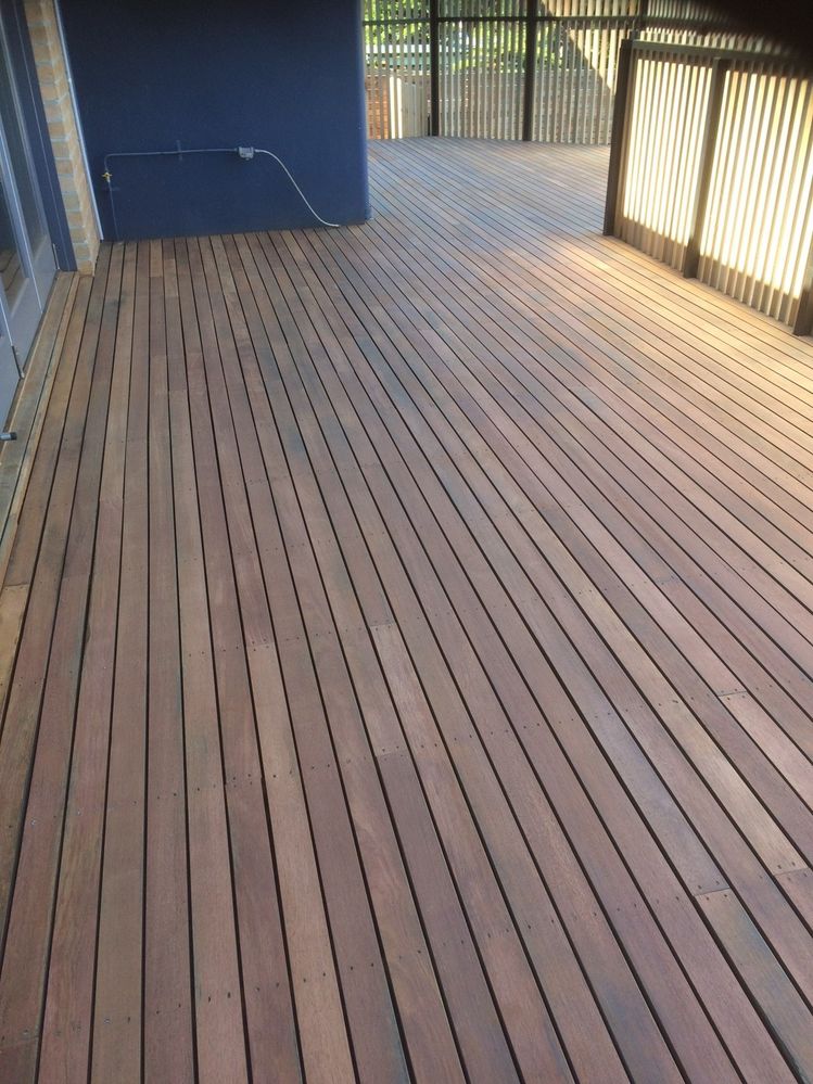

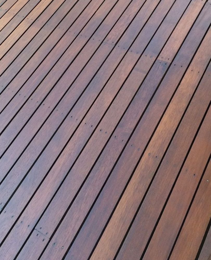

After cleaning up (getting rid of any sawdust that might contaminate the surface) I started oiling the deck. I got two coats done that weekend and a third the following week. I used Intergrain Ultradeck in Merbau.
It was a big improvement and a project well worth doing. I was really pleased with the end result.
