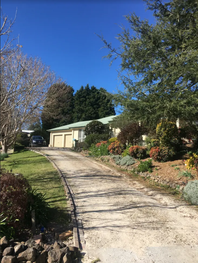

We have a sloped driveway on our property. It seems to be roadbase mixed with some sort of local gravel, and has been there for at least 10 years Iād say. Within the last 12 months, with such heavy rains around Sydney, the driveway has degraded, formed channels and washed away in parts. We need it redone ASAP.
To give you an idea of the slope: https://bit.ly/3pgASX2

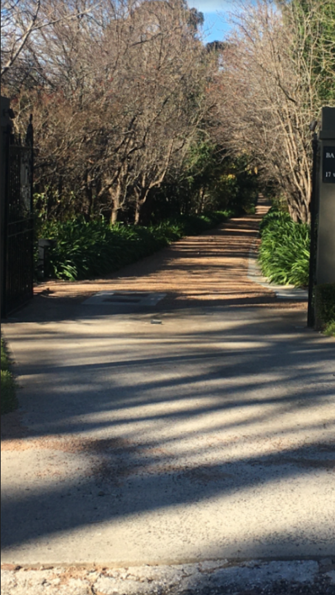

I have looked into the coloured bitumen option, but Iāve inspected some properties with a Bushmates coloured bitumen seal and it seems like even this becomes dislodged and may wash away? (See here: http://tiny.cc/3ygytz.) Certainly not as solid and stable as I imagined, unless Iāve got it wrong.
