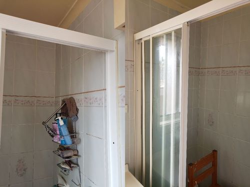

Old shower recess

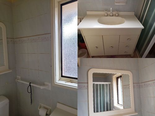

Before - dated tiles, mirror & vanity

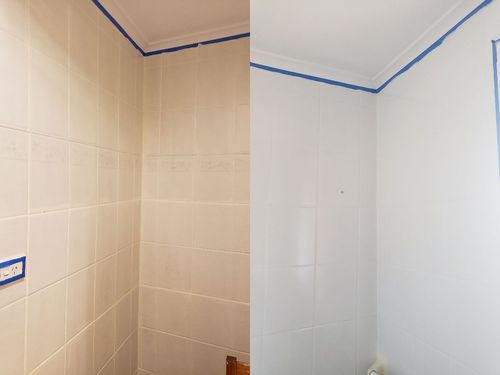

The old tiles were very high gloss, and despite every effort to sand them back before applying the undercoat, nothing worked, so I opted for using ESP which worked a treat! First pic is undercoat, second is after one coat of paint ... already a huge improvement!

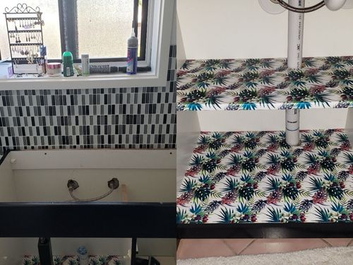

Vanity area during. This added extra work to the job as the tiles behind broke when removing the old vanity top (reckon they'd used about 4 tubes of silicon 😧) As the old tiles are not a standard size I had to come up with a Plan B ... sheets of mosaic tiles for the backsplash.
Repainted the vanity and lined shelves and draws with nice bright contact

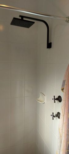

Finished shower with new black tapware & shower head.

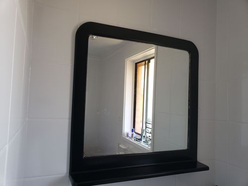

Upcycled the mirror with same paint used on vanity

I'm waiting on a black-framed shower screen to complete the room, so in the interim am using an aluminium extenda rail and a shower curtain.
