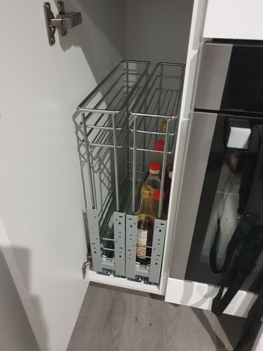

So our kitchen has some really weird door sizes. We want a nice place to stash cooking oils, sauces and vinegars (I love Asian cooking!), so my dear partner had an idea... How about we get some pull out inserts to save our backs and make better use of cupboard space!

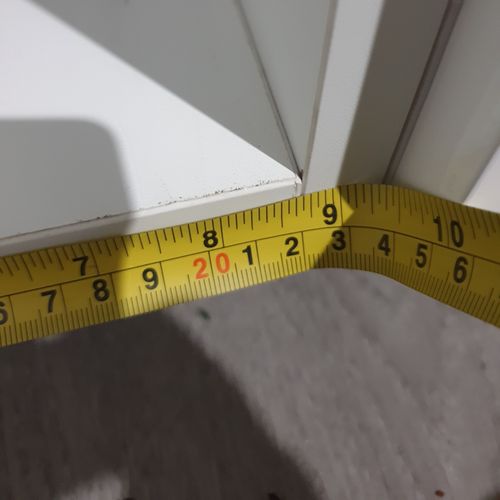

One problem... The cabinet we wanted to put them into is 220mm internally, with a 250mm exterior size! It's a bit weird for cabinets to be made this way, so we did a little research... Turns out Kaboodle is here to save our noodles! (and other dishes! Hehe)

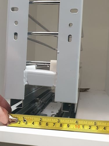

Their 150mm cabinet inserts are actually 100mm in width! That means with some clever enginerding, we can actually make two of these fit in our space!
And sure enough! We were right! With 20mm to spare on the inside edge as well!
We were initially thinking of bolting these directly to the door for a nice stable fit, but we may have difficulty getting access to the items in the rack closest to the wall... So, I intend on using some 100mm wide pine or some other timber to make faceplates with handles on them to allow us to pull out the racks independently
We'll keep you all posted as we make progress!
