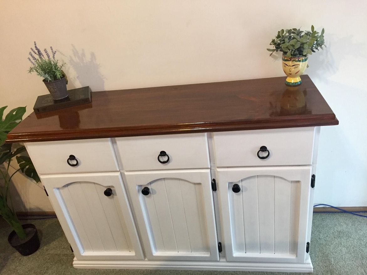

Let me tag our experienced member @DanaR who recently upcycled a beautiful buffet sideboard. Her finish on the top was impressive.

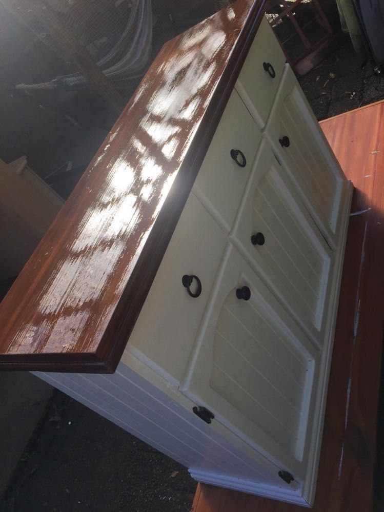

@MaryTonnz It's a bit confusing sometimes and even more so when there's so many choices! For my finishes, I follow 'Keep It Simple Sweetheart.' Meaning Bunnings has a simple option for just about every thing! I use Squirts Gloss Spray in a can. 2 Coats and the finish is like glass!
Simple. cheap and hard wearing.
