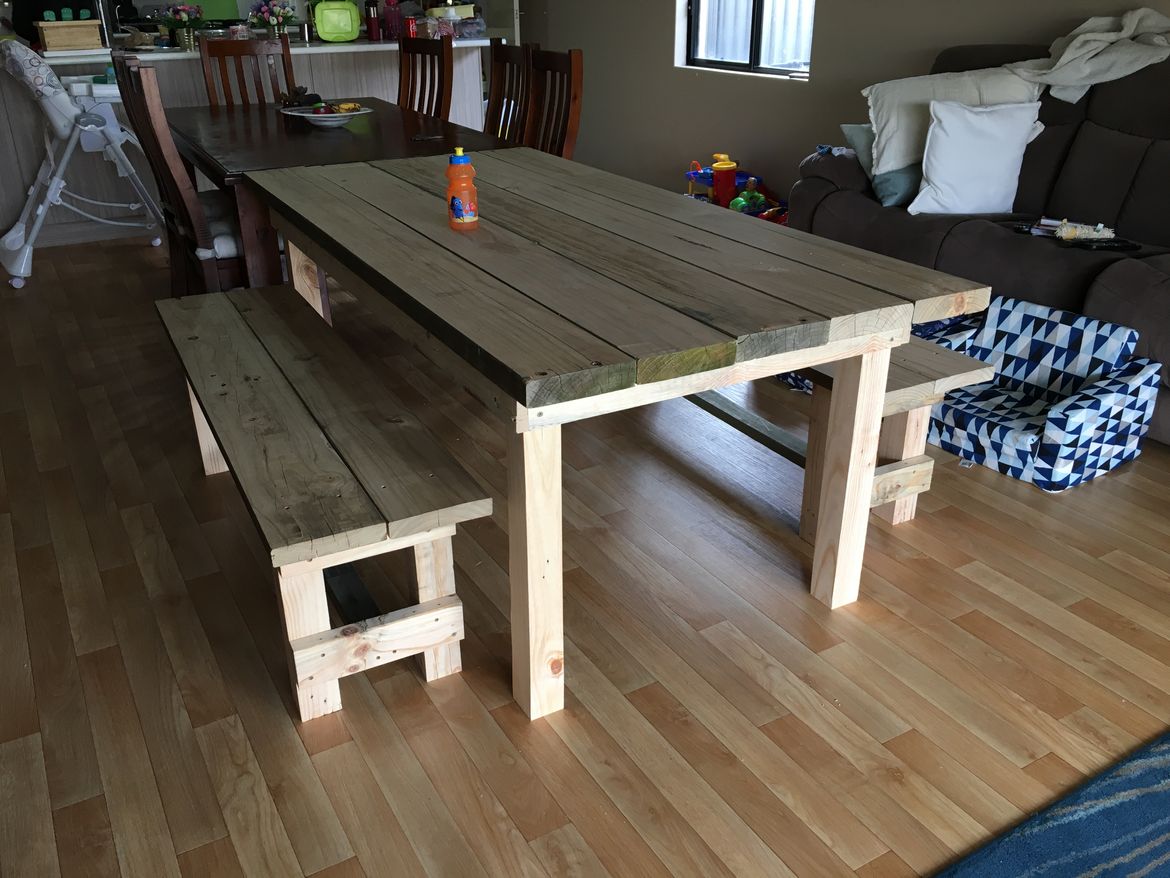

Knocked up this outdoor table and bench seats in a couple of hours using some timber I had lying around. I came up with the design myself and used custom measurements, but also drew on inspiration I found online.
I thoroughly enjoyed this build because not only was it a great challenge but I also got to do half of the build with my dad and show off my handiwork and skills.

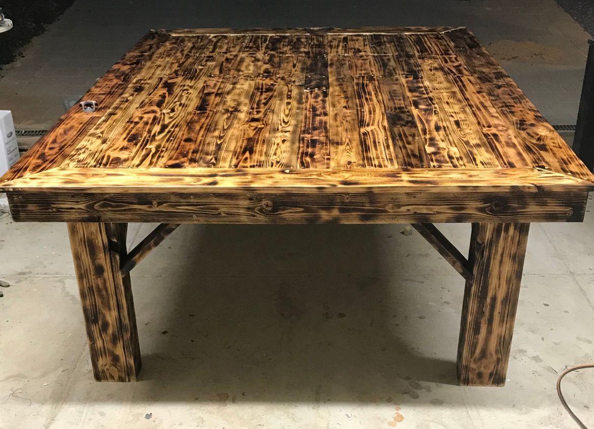

Rylie used a small gas blowtorch to apply a burn effect before applying timber oil to bring out the grain in the wood of this enormous outdoor table made from recycled timber.
