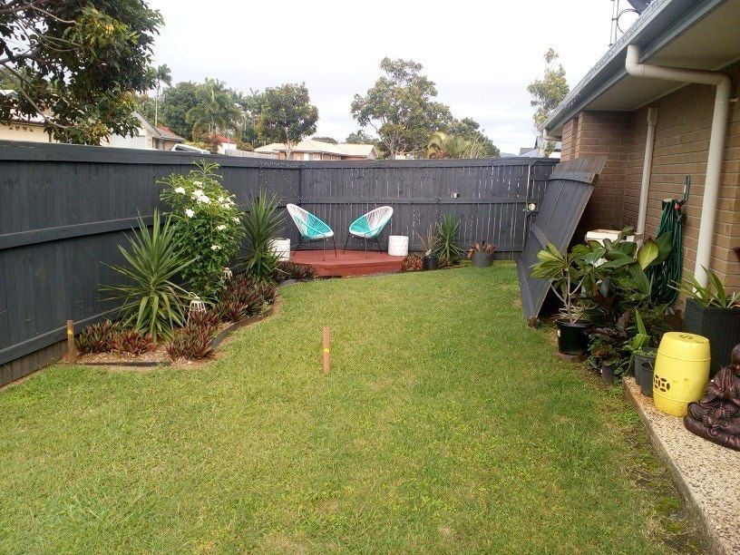

Like a lot of people, we had a bland backyard. After some tinkering – painting the inside of the treated Pine fence, and building a small deck and garden beds – my wife pushed me to jump into this renovation.

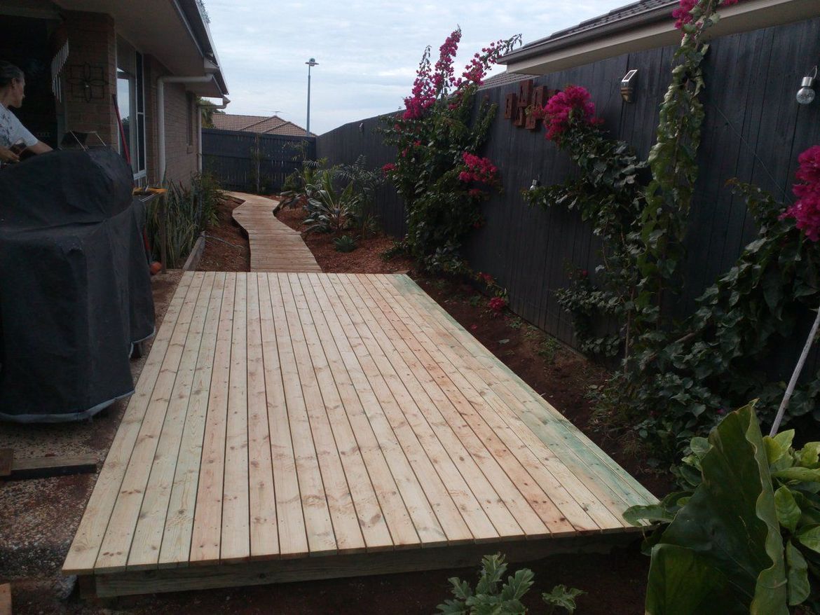

The concrete slab for the garden shed was outsourced – approximately $1,100. Recruited my (adult) children to spread mulch, erect the garden shed, and help build the boardwalk. I don't have exact figures but $350 for 5m3 Cypress mulch, $700 for the boardwalk timber (150 x 800mm x 25mm plank tops) and $1,100 for semi-advanced plants.

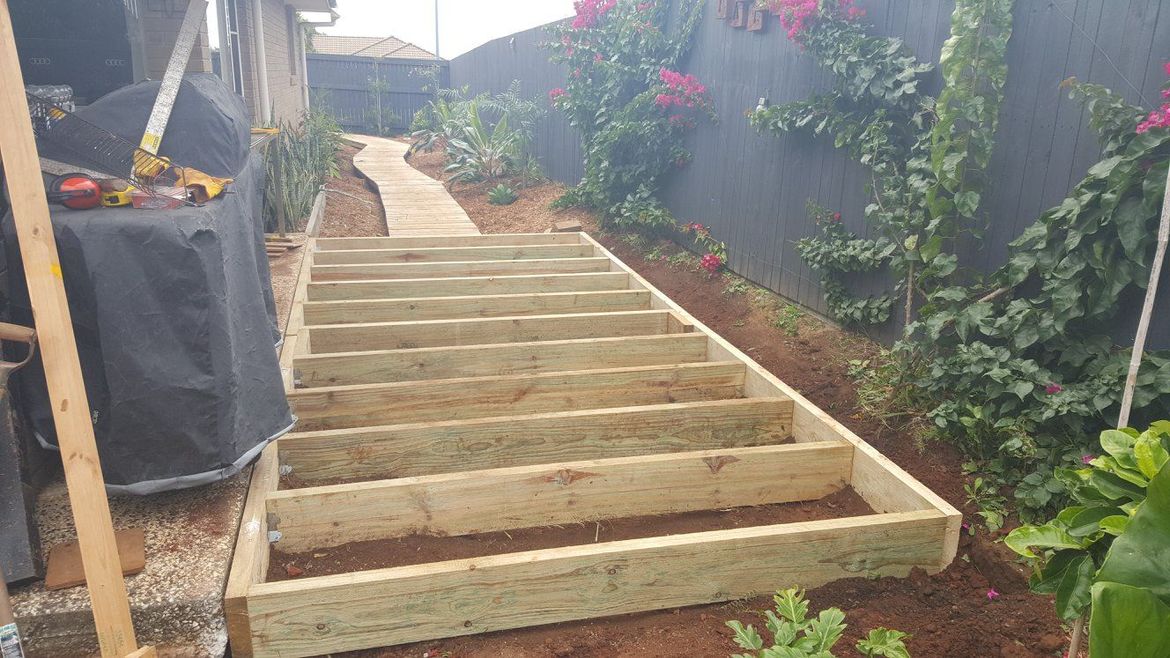

About a month later, we started on the side deck. I was finding the construction techniques a bit overwhelming as there's a 400mm fall between the house and the fence, so there was a bit of procrastination but we got there. It was around $1,500 for the timber, hardware, and nail gun hire.
Starting out on the side deck

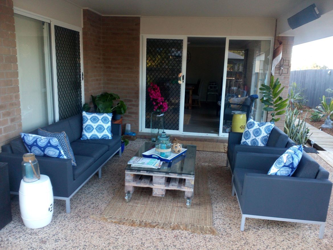

We've more than doubled the alfresco area, so it's gone from being a holding space for the barbecue and table to a relaxing space.
Before and after
