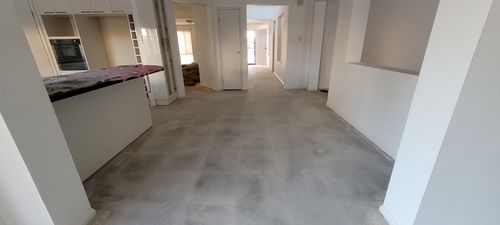

Hi, I've ripped up old tiles and sanded down the old adhesive, do I need to put primer before tiling new porcelein tiles?

It is always good practice to prime tiling surfaces whether old or new. I recommend giving the floor a good wash to remove any dust to prevent tile adhesive failure. Once the floor is completely dry, I suggest using Dunlop 4L Multipurpose Primer. A four-liter bottle covers approximately 24 square meters.
