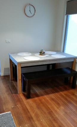

I bought a secondhand table and bench seat combo. It was the perfect shape and size that we needed, but didn’t match with our decor. It was a dark brown laminate, which had seen better days, chipped and scuffed from the previous owner.
I sanded back the laminate on the chairs and table to see what was underneath. It’s a pretty heavy unit so I was hoping it was something decent. The legs of both the table and bench seats were a nice timber, the tops of the chairs and table were a thick chipboard, which would still work well for what I needed.
I had done what I thought was a fair amount of research on concrete tables, but the concrete was still a bit of trial and error. The first time it didn’t work, even after the back-breaking hours I spent smoothing, it just wouldn’t stick to the timber when dried. After further research, I found the right cement to use and also a high grade clear matte concrete sealer, and presto! A concrete tabletop. I lacquered the table legs in a nice natural stain and sprayed the chairs completely in black satin for contrast. The black also helps tie in with other furniture and accessories in the lounge room.
The process was time consuming and did end up costing more than expected, but it's a lot cheaper than buying this new from a store. Now we can eat at our table again.

Other than the cement and sealer, you can pick everything up from Bunnings. Unfortunately normal cement just won’t stick to timber because when the timber expands and retracts with temperature, the dried concrete will crack away (learned this the hard way).
The Aqua Mix sealer I used is on the expensive side, but after reading many reviews with people struggling to manage stains on their concrete tables, it was a worthwhile purchase to find something that is heavy duty. So you don't have to be that person who yells at your guests for putting ice cold drinks directly down on the table for fear of rings.

11. If you are looking to sand this down until you achieve a polished concrete look, then I’d recommend you do a minimum of five layers. I was only going to do three layers, and then I had a spill and dribbled water on a corner – water will stain your table until it is sealed – so I had to do a fourth layer to cover it, and then I sanded it back with 120 grit sandpaper with the electric hand sander. I still wanted to have some texture to the table so that it is smooth yet showed some definition.
12. Once you’ve achieved the sanding results you are after, it's time to seal it. I used a small soft foam roller to apply the sealer, and ended up having streaks where the roller was. Very faint, but I can still see them. So I’d recommend you use a soft cloth and apply the sealer in circular motions. Make sure you wear gloves as this chemical can react with your skin. Again only do thin layers – the thicker you apply it, the more it may leave streaks.
13. Leave each layer to dry for 30 minutes in-between coats. I applied four coats of sealer in total, and you do start to notice layer by layer that it’s not absorbing as well, which means it’s working. Make sure that you wipe away any sealer that just sits on top and is not absorbed after a few minutes with a cloth. After the last layer, leave it to dry well before use. The instructions say that within two hours of the final coat it can be used, but I left it for a day, just to be sure.
I wanted a table that was still a bit rustic with a matte finish rather than shiny polished concrete. If you want a gloss finish, you’ll need to spend time polishing the concrete with a fine grade grit sandpaper, and look for a gloss finish sealer.
You won’t be able use regular surface cleaners when cleaning and maintaining your tabletop as they may mess with the sealer. Best to just dust off the surface, and if you spill, wipe it up straight away. Since this is a dining table, which will come in contact with food, grease and everyday messes, I invested in Aqua Mix AquaShield Cleaner & Resealer to clean the surface and also top up the sealer.
I have still been paranoid about anyone spilling or putting things down on the table without a coaster, but I have been paranoid for nothing. The liquid sits on the surface and can be easily wiped off. I've had greasy mess also splatter on the table, as you do, and it also wipes off easily. I still ensure that if a mess is made, it isn't left long enough to make a difference, and never wipe it off with water or general kitchen spray, always with a cement cleaner spray and dry cloth. Like any surface, I always use a trivet before I put hot items down.
I have been slack with the maintenance, as I told myself I'd wipe the table down once a week with the Aqua Mix AquaShield Cleaner & Resealer, but it probably only gets a good wipe down every couple weeks. It's still as strong and unmarked as the day I made it.
