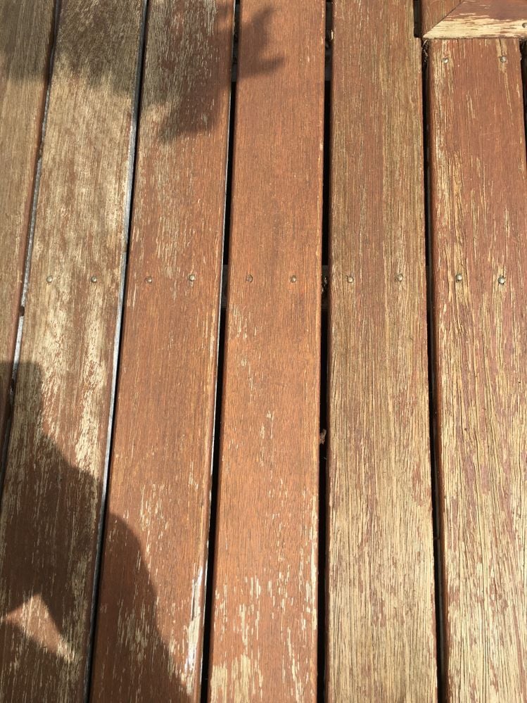

Our deck was about five years old and ready for re-oiling. The original stain was Cabots Aquadeck and it had six coats on from the previous five years' use. As the deck is covered, it only weathers on two sides, with the less exposed regions appearing almost pristine. To sand it back was just too hard for me – maybe with an aggressive belt sander or something, but I didn't really want to go gouging out a few millimetres of board to get rid of the stain. After earlier failed attempts, I knew that a total strip and sand would be necessary to get the best result.
Initially I resorted to using PowerPrep and the pressure sprayer, which wasn't quite enough for stripping back the existing deck finish. Here is one of the initial stages of using PowerPrep.

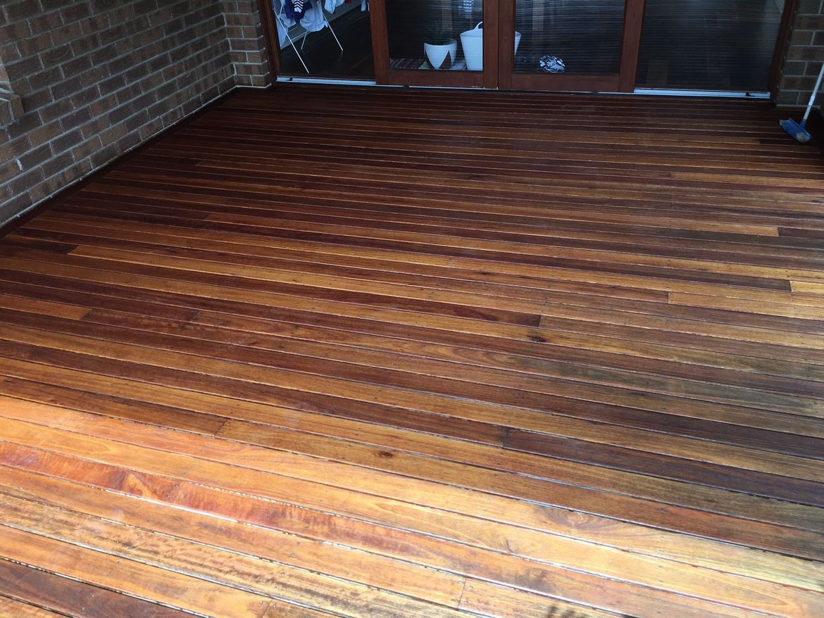

Here is the deck after the first coat of Intergrain Nature's Timber Oil.

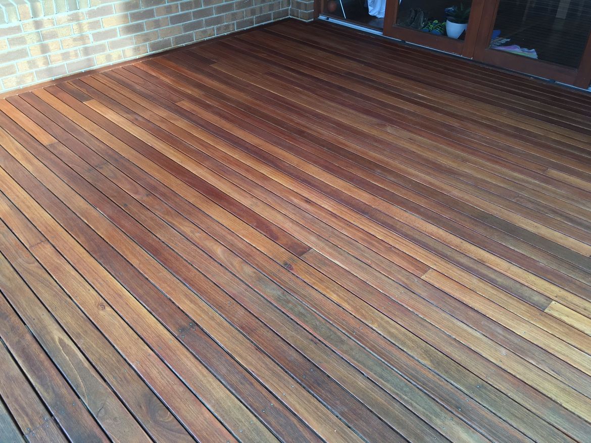

And after the second coat.
The deck is made from River Reds hardwood, which has almost as many colours as Spotted Gum, but is primarily pinkish with the odd bit of almost pure white. The whiter boards have taken on an orange tint, which isn't overly pleasing, but I think next year when it's due for another oil, I'll whack a Jarrah tinted Nature's Timber Oil over the top and darken it up a bit.
