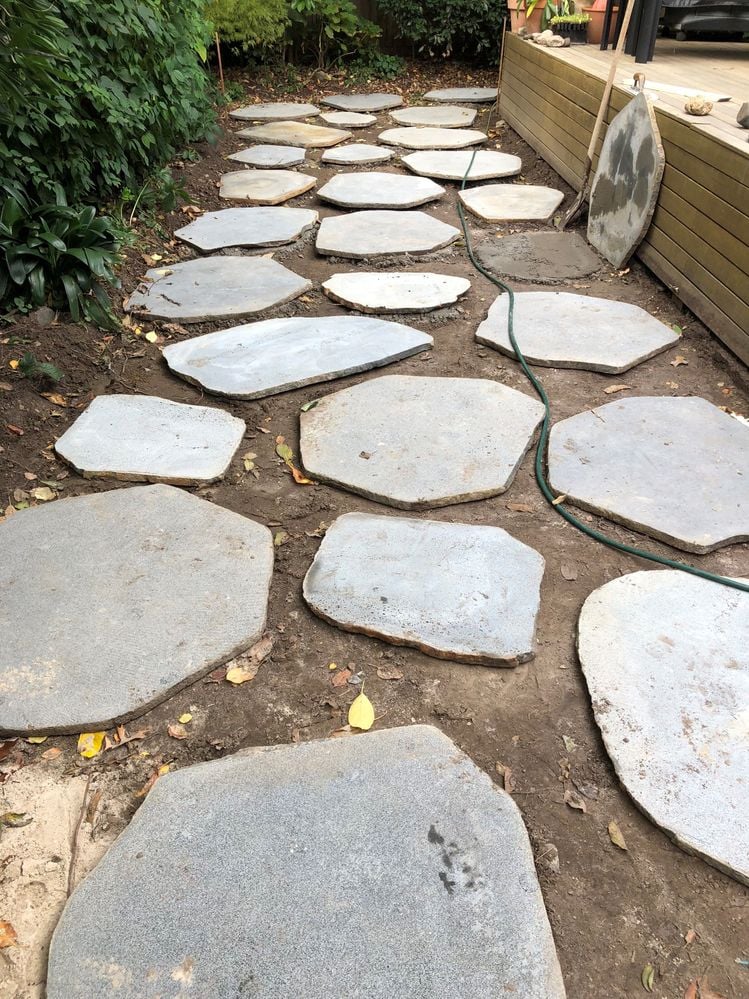

We used a ratio of one part concrete to two parts sand and three parts gravel. Mixing the concrete by hand in a wheelbarrow was slow going, so we borrowed a small cement mixer to make it quicker and easier. We also realised we should have put a string line down and left it. Some of the first rounds we laid are a little too low.
Laying the rounds was really easy. We used a mortar mix to make sure they wouldn't move. If you use thicker rounds and a bit of pavers sand, they probably wouldn't move.

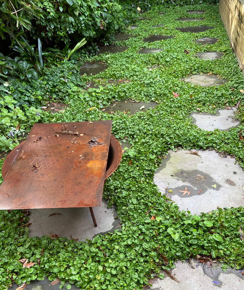

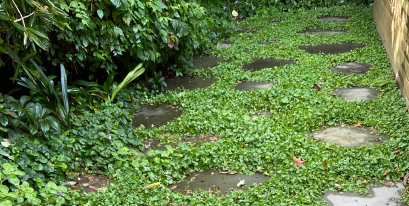

Dichondra is growing beautifully as ground cover between the pavers.
Before and after

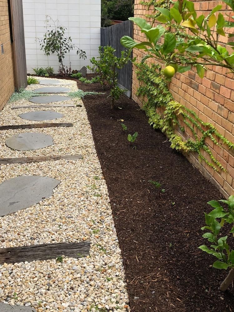

Workshop Community Manager Jason built a rambling path from his front gate to the front door using Bluestone rounds to make the trek in wet weather a little easier.
Jason also made use of Bluestone rounds in the narrow walkway down the side of his house alongside river pebbles and railway sleepers.
