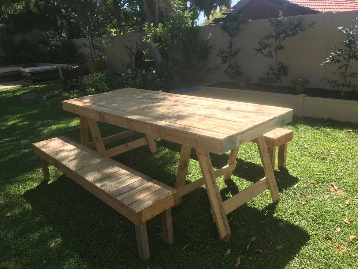

I took two pallets apart completely and inserted the strips of wood into the gaps on the other set of pallets to make the tabletop solid. I sanded for smoothness, but left some paint marks for a rustic look. The fact that all of the wood was slightly different shades added to the overall effect. After joining the two pallets and strengthening underneath the tabletop, I secured six table legs with brackets.

Workshop member Yorky88 used just two pallets in this terrific outdoor dining build.
