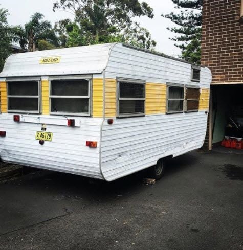

This van is over 40 years old, and there were a few dents on the outside of it. I filled a couple, but left some. I painted with full gloss enamel paint, and used a roller rather than painting with a spray gun. I also added turps and Penetrol to the mix so that it settled and gave a sprayed look. I didn't add any trims to the windows, just sanded them well and sprayed with silver paint, which brought them up really nicely.
