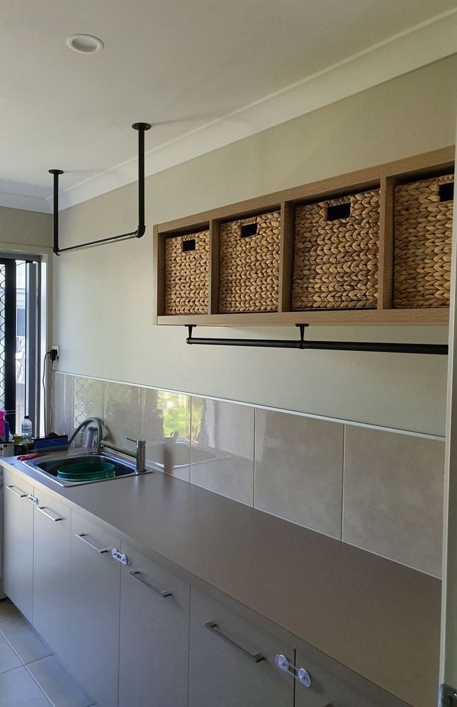

I made an industrial hanging clothes rail using a steel pipe that hangs from the roof, and I reinforced the ceiling with timber for added strength. I wanted a small hanger too, so I got a black rod to match the painted one hung on the ceiling. While I was in Bunnings searching for the materials, a lovely team member gave me with the idea of a cube shelf for the other side of the wall, with brackets hidden in the squares to give the illusion of a floating shelf.
How to build an industrial hanging clothes rail
An industrial hanger is easy to make and will solve your hanging space issues in style. The Bunnings team has shared a step-by-step guide about How To Make An Industrial Clothes Rail.
