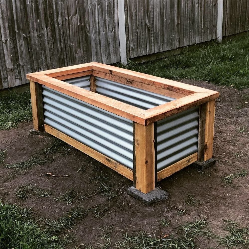

Bunnings Workshop member moshiach77 built this impressive raised garden bed using corrugated iron, Cypress timber, hardwood sleepers and recycled pallet timber.
To cut the corrugated iron to size, he used a 1mm cutting disc on an angle grinder and clamped a piece of angle iron to the sheet as a guide.

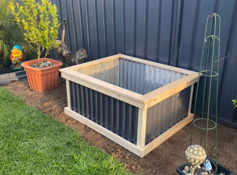

Workshop member crazycrisi achieved a similar look using Colorbond edging in their raised garden bed build.
