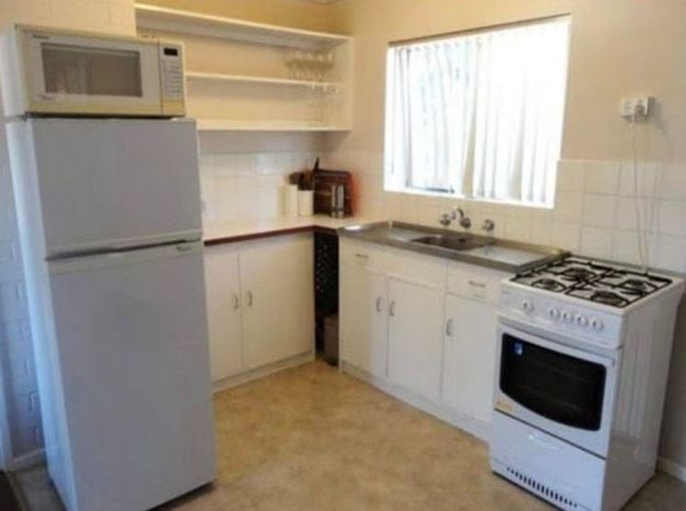

I recently completed a renovation of my in-laws' rental unit. It's a third floor one-bedder and the whole place was starting to look tired, dated and a bit grubby. In particular, the kitchen had very little bench space and a horrible old freestanding gas oven/stove combination.

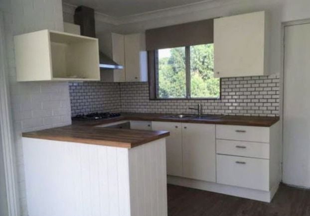

To begin the renovation, the old lino flooring and carpet was ripped out and I installed a water-resistant laminate flooring in the kitchen, living and bedroom areas. This was my second time installing floating laminate floorboards and I love how easy and quickly they come together.
Once the painting and floors were complete, it was time to update the cabinetry. We went for a Kaboodle kitchen set up ordered through our local Bunnings. I found that the Kaboodle planner tool was pretty easy to use and it allowed us to print a list of all the pieces we needed to order.
The cabinets went together reasonably easily – I did have to cut two cabinets down to size with a circular saw as the space I had to work with was slightly smaller than off-the-shelf dimensions. I have since realised that Kaboodle will make cut-to-measure cabinets, which I will be trying next time.
Once the cabinets were in, I had an electrician and plumber install the oven, stove top and water connections. The final tradie job was to have a tiler retile the splashback with subway-style mosaic tiles and black grout. To match the benchtop, I also used a small Spotted Gum panel to reframe the window sill.
As this project was done around my full time work, it took six weeks of weekends and evenings to complete the whole unit, but it was a really rewarding experience.
