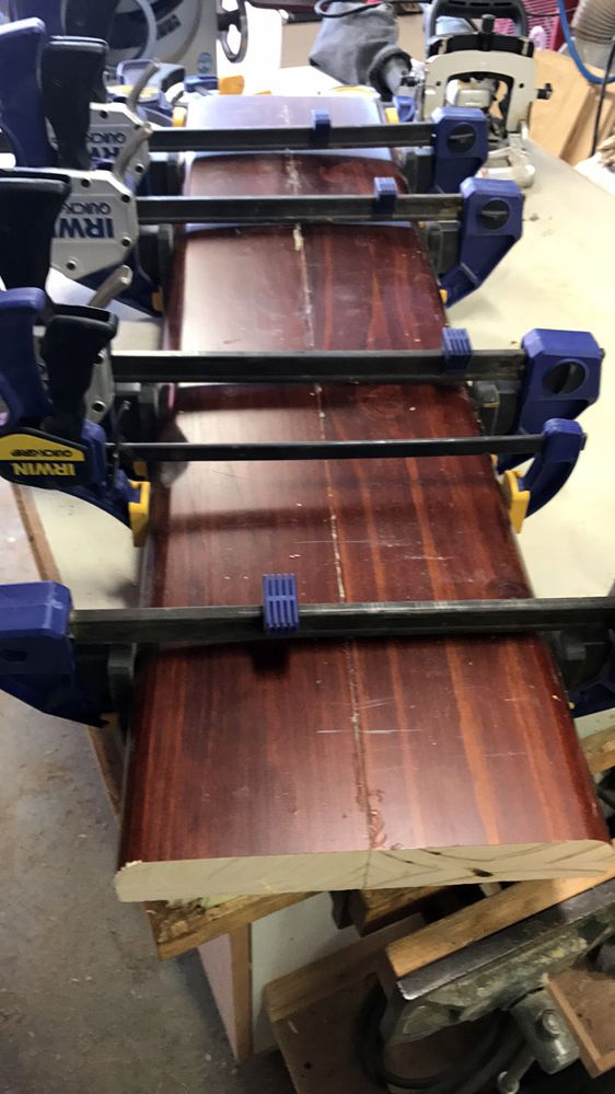

This was originally a dining table top that I picked up at an auction. I cut it on the table saw and joined two of the thicker 40mm edge panels together with PVA glue and biscuits. It is 900mm wide and 240mm deep.

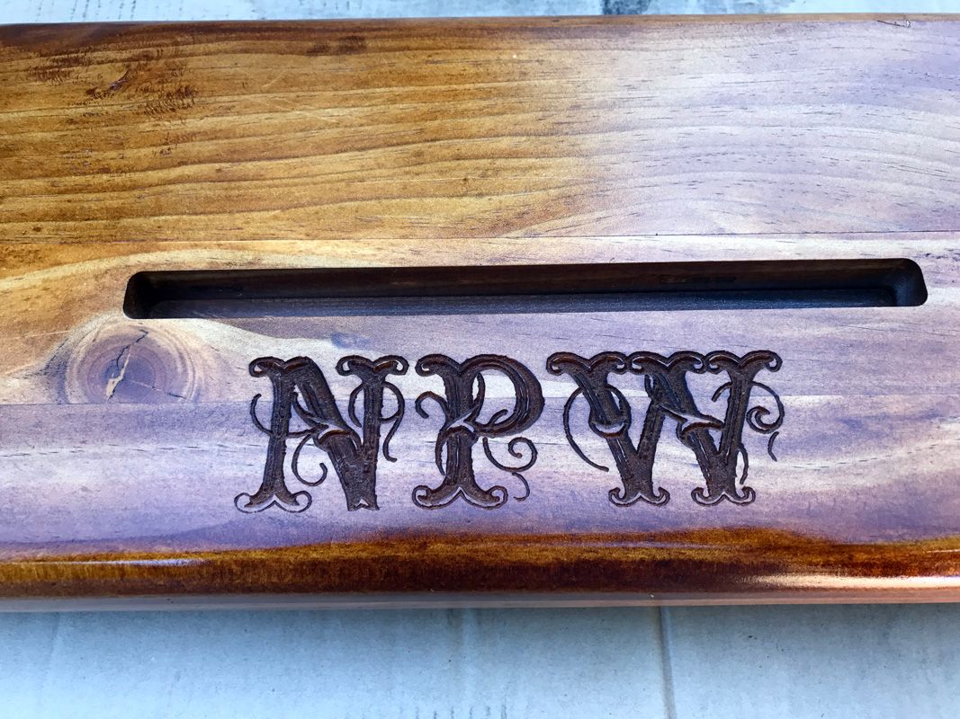

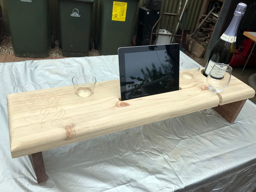

I drew up the design in CNC software and carved a slot for an iPad, recessed pockets for tealight candles and a wine bottle and also a cut out for a wine glass. I engraved a rose design on the left and also a monogram of the recipient's initials NPW.
I first sanded the original finish back to bare timber.

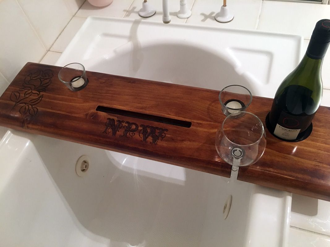

I stained it and sprayed with five coats of clear lacquer, then waxed and buffed it with my homemade furniture wax for additional protection from water splashes.

To prevent the bath caddy sliding around, there are two strips of rubber on the underside where the shelf makes contacts with the bath.
