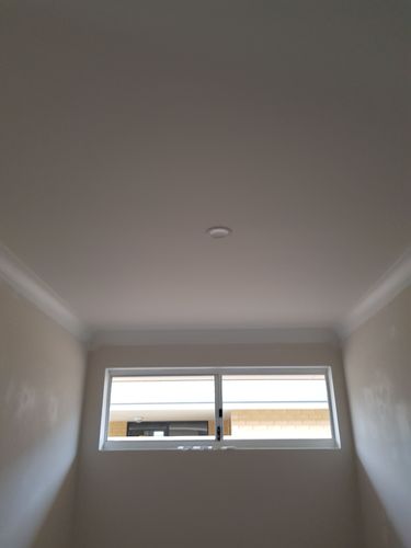

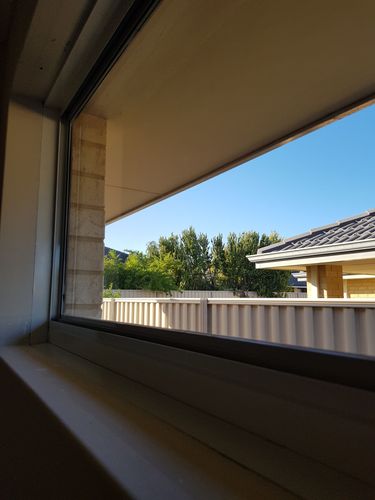

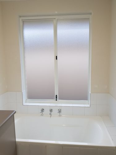

Hello
We are renovating our home and I have have spray painted our aluminum windows from blue/black to white.
Eric has provided you with all the info.
When I sprayed my very first window I was nervous but after a while you will get the hang of it.Â
I'm doing the laundry windows tomorrow.
All the best.
Thankyou ! They look fantastic.Â
