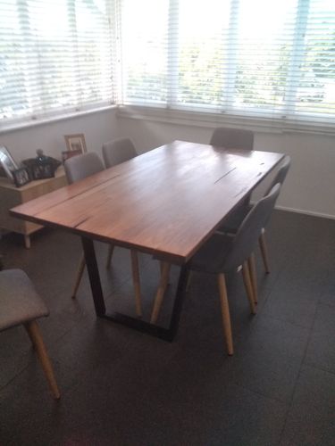

In need of a dining table & not a fan of flat pack, I had previously made a table using a merbau fence panel . That's now being consigned to the outdoor after I made a new one using rapidmesh legs and a laminated panel like this one. Was looking at some merbau specials (1800*900 & 2100*1050) when I found another (2400*900) that was Aussie gum (Ash). Although it's finger jointed, it has more character IMO. Cut it back to 1800, rounded all edges (router), stained, then attached legs. Et voila....
Sorry, didn't take before photos but if you've seen ash timber, you'll know it's very light coloured.
