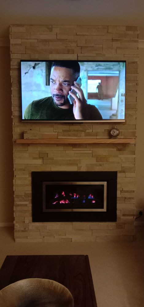

This one was fun to knock down - finally completed the last room in my house which has been empty for the last 4 years.

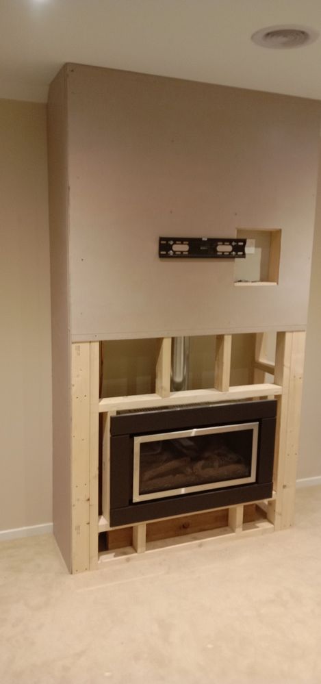

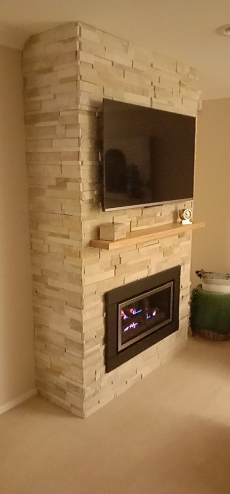

Quite straight forward to build; timber frame, cement sheet and stone cladding. Gas heater installed by qualified trade and other than cutting almost every stone piece, this was knocked down in less than a week. Cutting of the stone was a nightmare in the sense of the mess that it obviously makes, I did all cuts in the garage and everything was covered in dust.

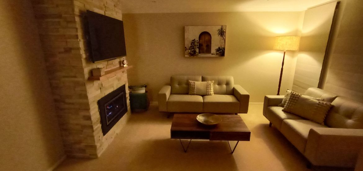

Best advice I can give is to have a good quality masonry cutting disc for a small grinder, this will make cuts much easier. Splashed some cash on some furniture and it is the perfect spot once the kids go to bed!
