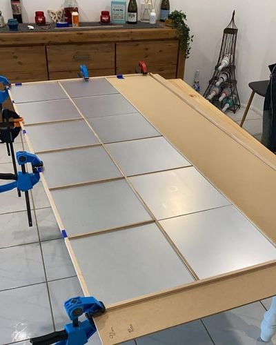

Firstly I got my measurements (wrong!!) and got my board cut by Bunnings. Lucky for me, my measurements were too big! I thought I had 30cm mirrors and they were 28cm instead!

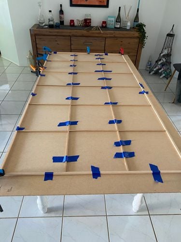

I started with the outer frame using 9mm square trim. I dry fitted the mirrors & used a drop saw to cut each of the 6mm inner frame trims to create the grid. Because the backing board (6mm MDF) was cut too big, I used a handsaw to cut it down.

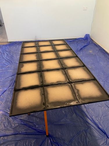

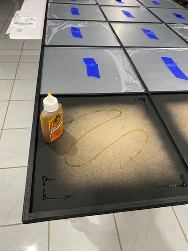

I then used Gorilla glue to fix the trim and taped it down over night. I sprayed all the trim with flat black Rustoleum and then fixed the acrylic mirrors down with more Gorilla glue.
The whole process took 1.5 days. It was quite fiddly getting the grid perfect and the glue needed to settle overnight.

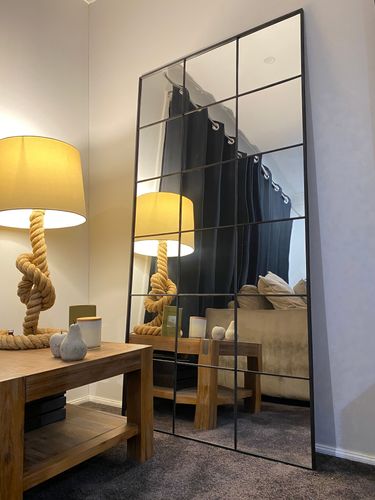

Happy with the result
