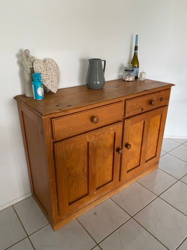

I asked on marketplace if anyone has an old buffet they wanted to sell. A really nice lady reached out and said she had this old unit i could have for free!
Having already made-over a unit like this before, I had learnt from some mistakes.

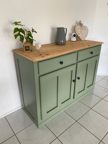

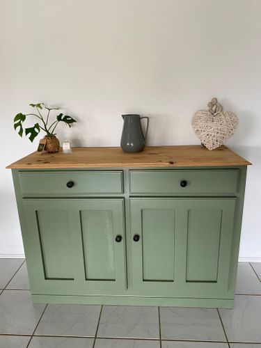

I started by removing the doors and draws and giving the whole unit a light sand to the areas i was going to paint using 120 grit sandpaper; & I really went to town with an orbital sander for the top, starting off with 80grit, then 120, then 240 for a smooth finish
I went straight into painting from here. I applied Dulux Aquanamel in Semi-Gloss using a roller and a brush to get into the corner.
The colour I chose was Open Living by British Paints.
After 2 coats and once it was dry, i put the doors and draws back together and added new black handles.
To finished it off, I used the Cabot's Cabothane Clear on the top
