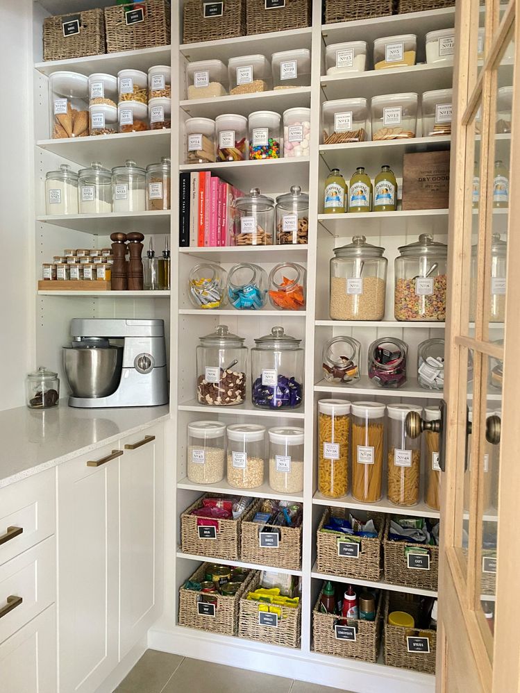

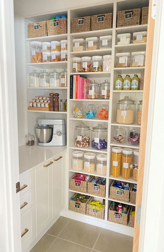

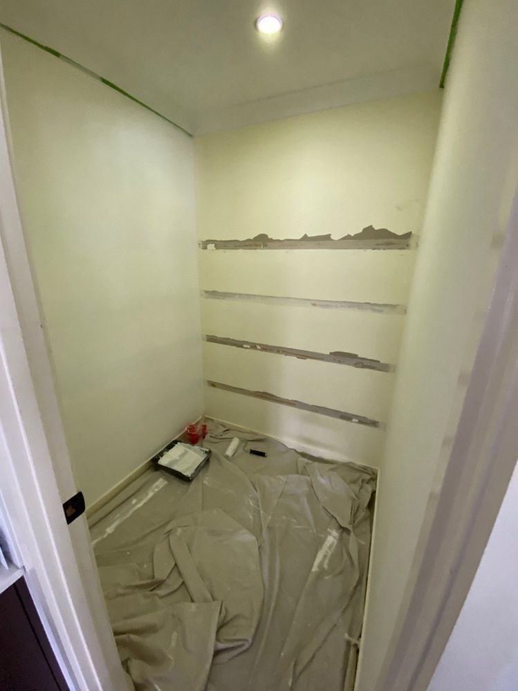

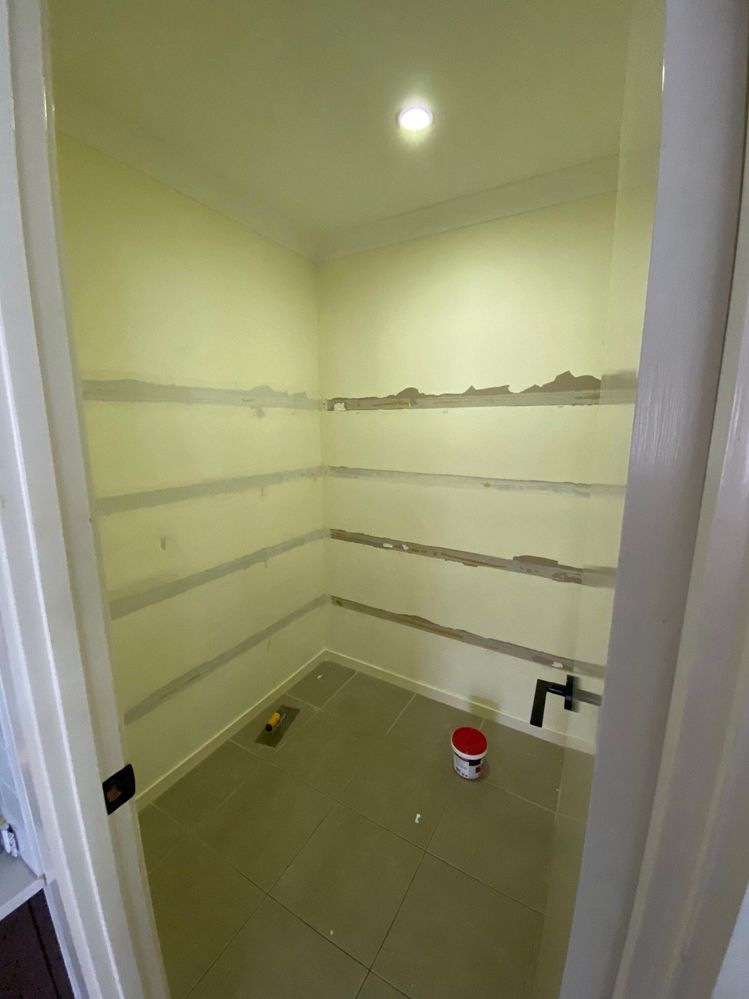

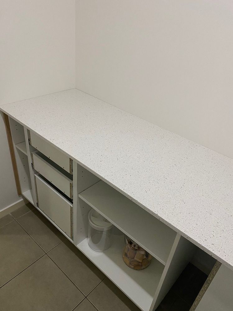

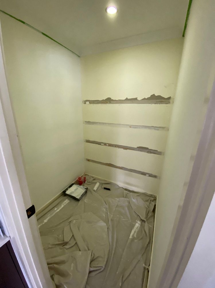

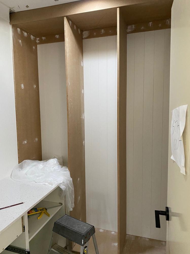

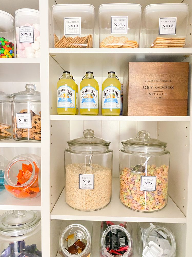

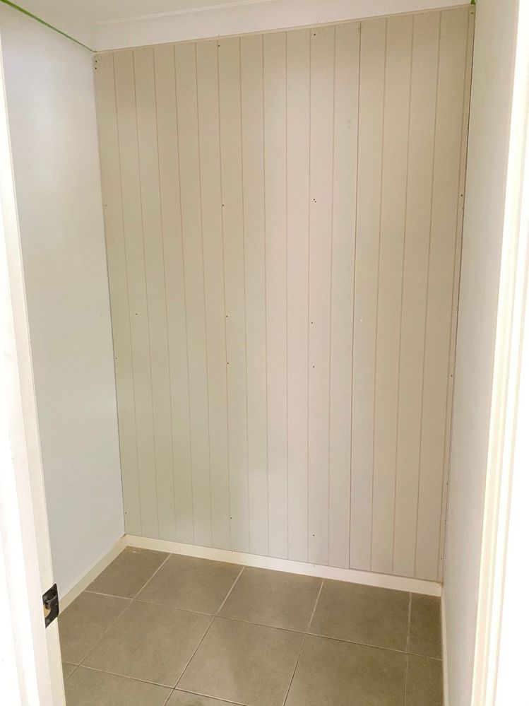

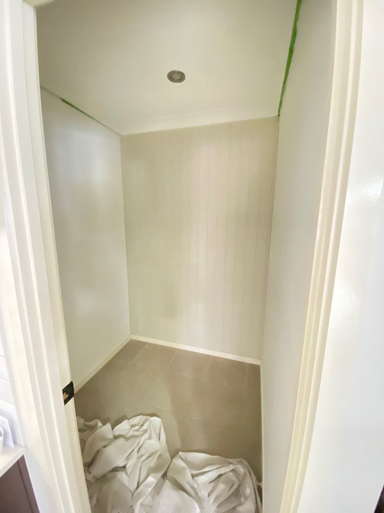

We decided to convert our builder standard walk in pantry into a stylish, functional and practical butlers pantry. We did all the work ourselves, from gutting out the original fittings, plastering, painting. My husband built the custom floor to ceiling open shelves using mdf, which we painted to match the kaboodle kitchen cabinets. We love how it looks and more importantly, how the space works for us, as everything has a place now, which means its always organised and tidy

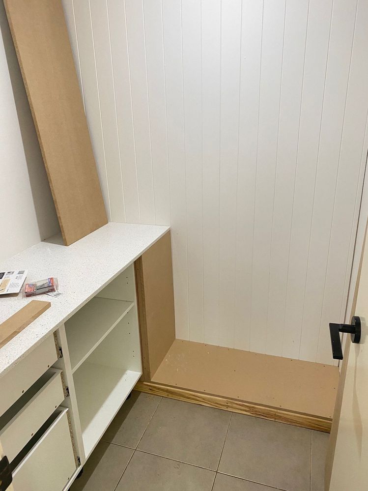

MDF STANDARD PANELS 2400X450X16, cut down to 420 for the shelf sides. Same panels used for the shelves
Pine for the base
Kaboodle cabinets - 2 door cupboard 600mm, 3 drawer cabinet and 200mm cupboard

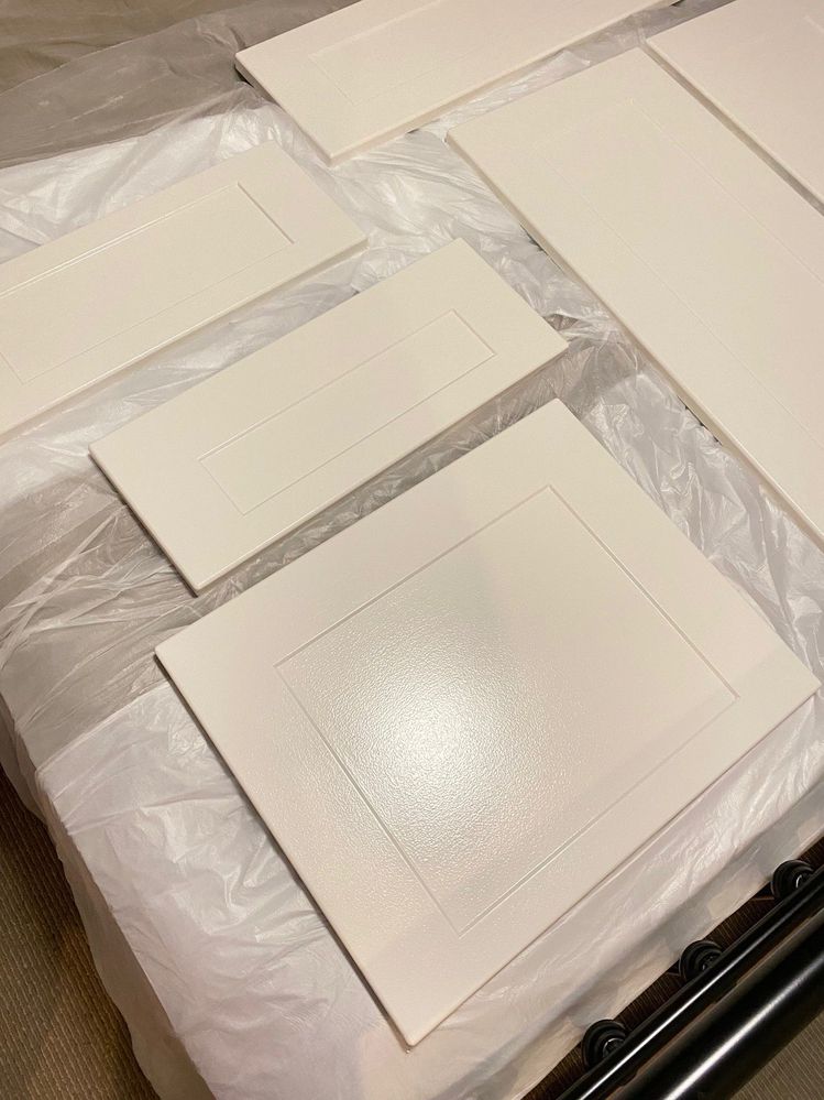

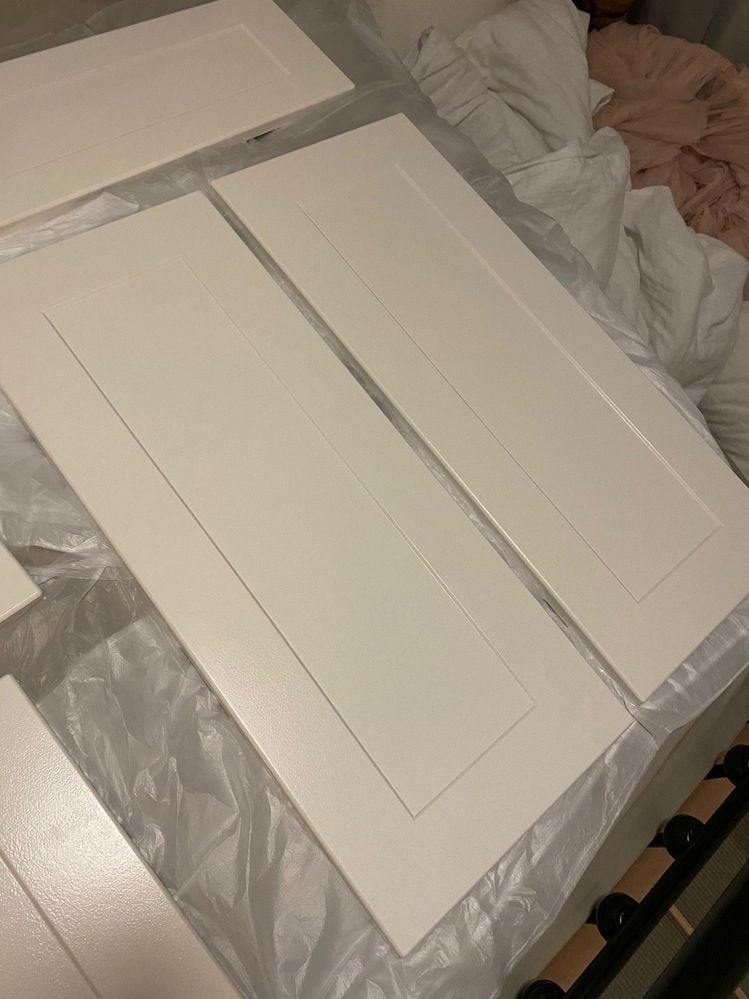

Raw mdf kaboodle door fronts

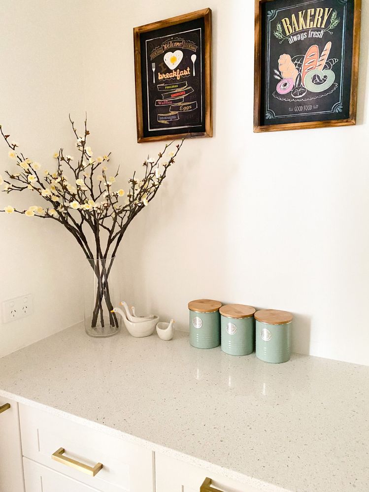

Caesarstone benchtop

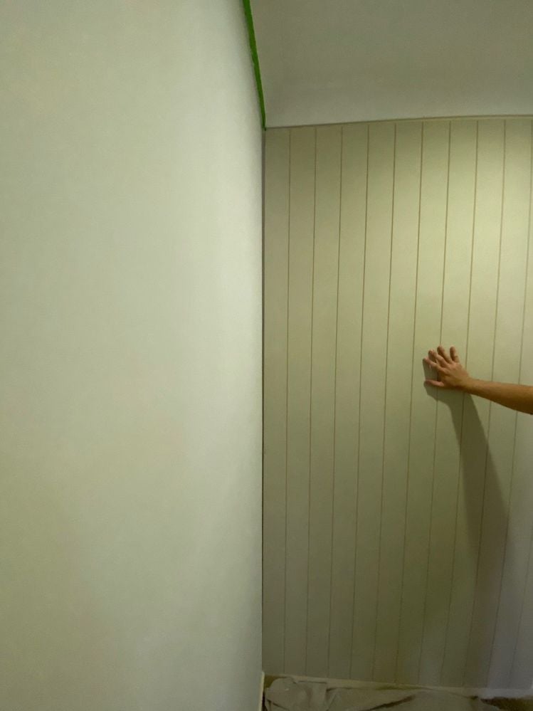

Easycraft panels for the back wall 2420X1200 9MM EASYVJ
Dulux Natural white for the walls
Dulux semi gloss in Beige Royal Quarter for the cabinets and shelves

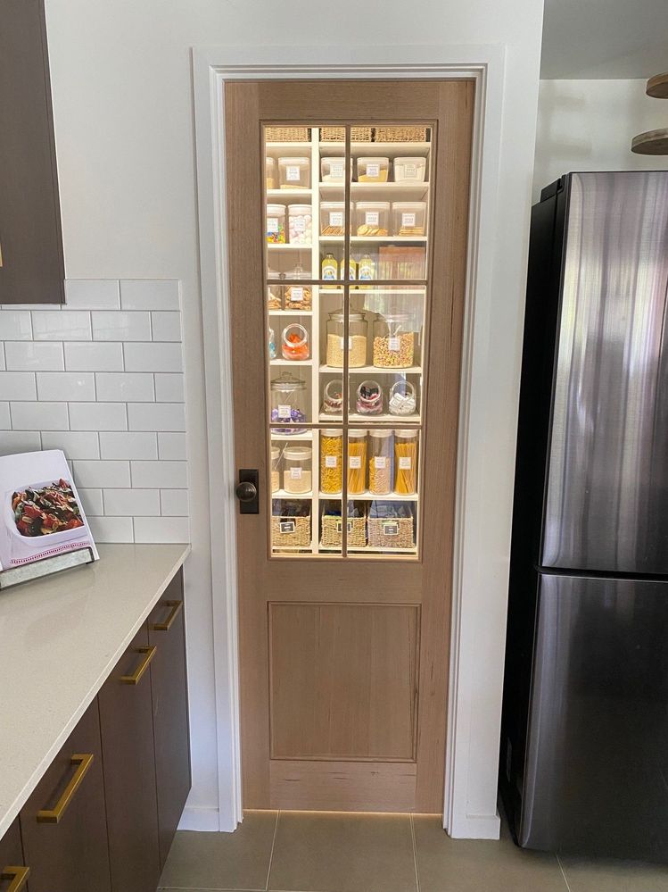

Door was custom made
