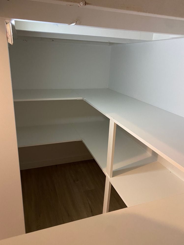

Measure the space and place tape on the floor to mark it out. Find the studs in the wall and tape where the middle of the stud is for future reference.
Step three
Cut your support pieces to size. I used leftover skirting boards from our build.
Step four
Secure these boards into the studs, making sure you secure it in enough spots so that you have maximum support.
If your shelves are long, make sure you add in a support piece from the ground to the bottom of the shelf.

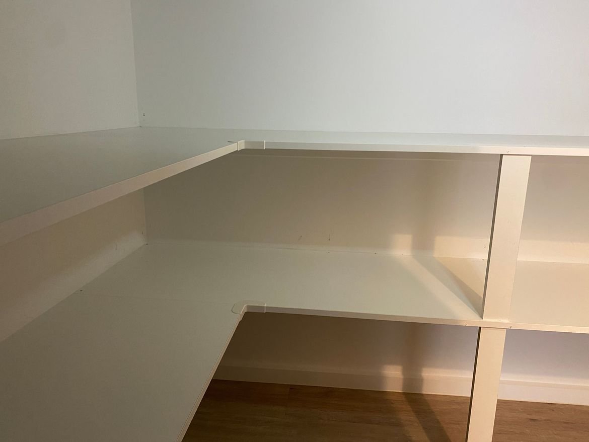

Place Liquid Nails on the top of your supports and place the melamine on top, pre-drill a few small holes in the top of the melamine and secure with a flathead nail.
Step seven
Use Hafele corner shelf brackets to stabilise and join your corners.
Step eight
Put silicone in the joins where the shelf meets the wall, and join if the melamine meets another panel.

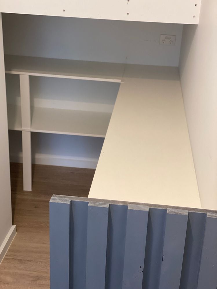

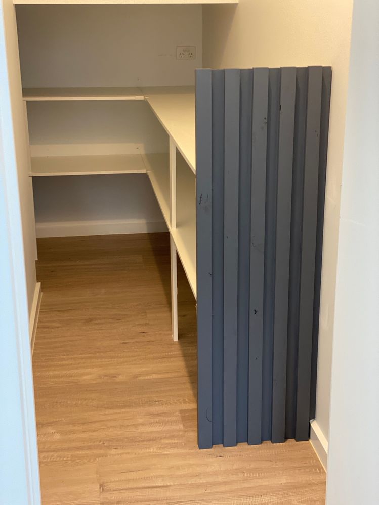

Step nine
Add in a feature at the front if your space allows.
