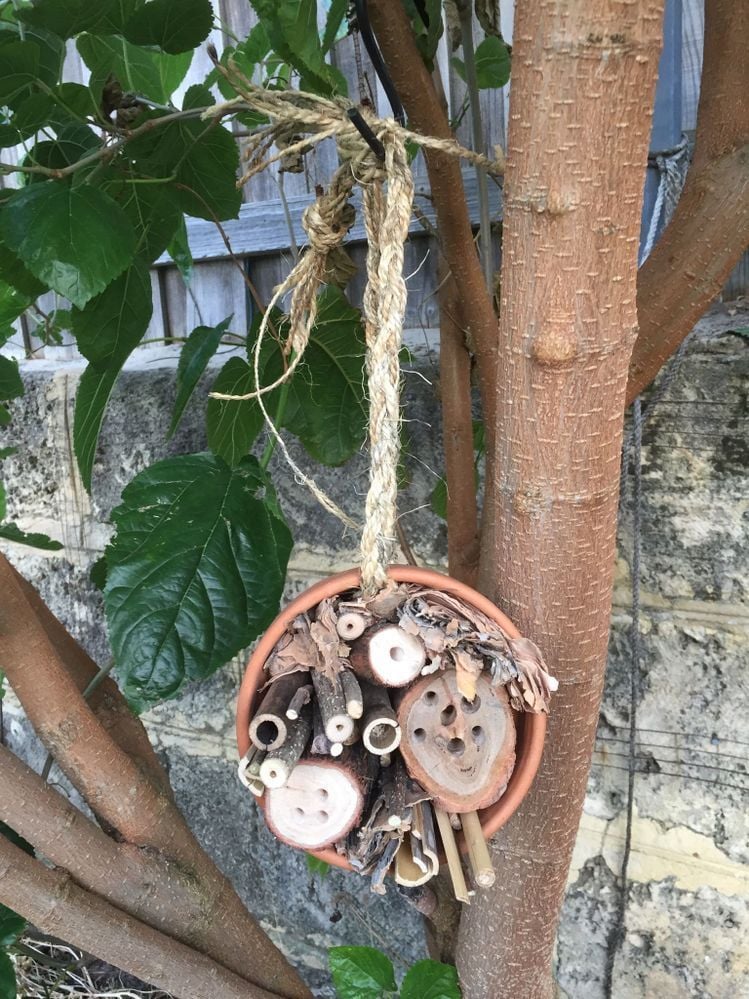

Workshop member mich1972 created this hanging bee house using a terracotta pot, braided sisal and branches with drilled holes from native trees and shrubs that needed a prune.
