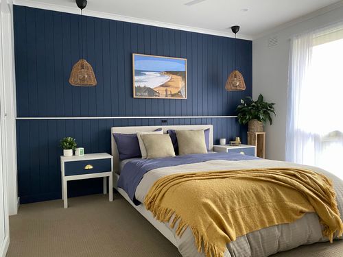

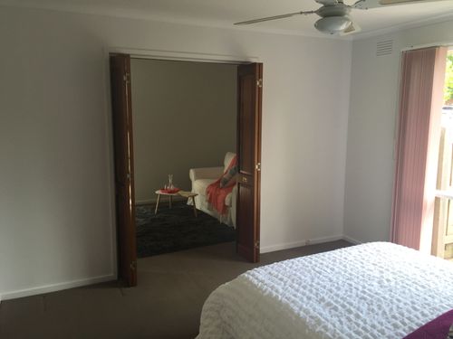

Some big changes to this room, which included closing off the parents retreat to turn into a study (the parents retreat had a separate entrance) and my favourite feature being the nib-wall.
Firstly the bifold doors and jamb had to come down. The door jamb was solid Tasmanian Oak, so I saved these for the shelf on the nib-wall.

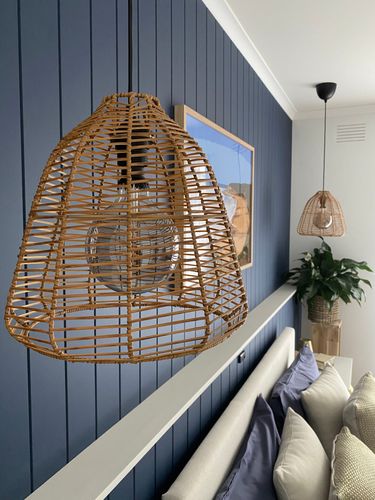

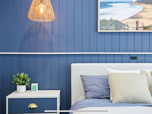

Then to close off the doorway with a 90x45 frame and a nib-wall using 90x45 all the way across the bottom; quite simply covered with VJ panelling & my favourite paint; Porters Paints in Yacht Race. Finished off with the door jamb for the shelf (also painted in Porters Paints Rubble)

✅ New pendant light shades which I just love

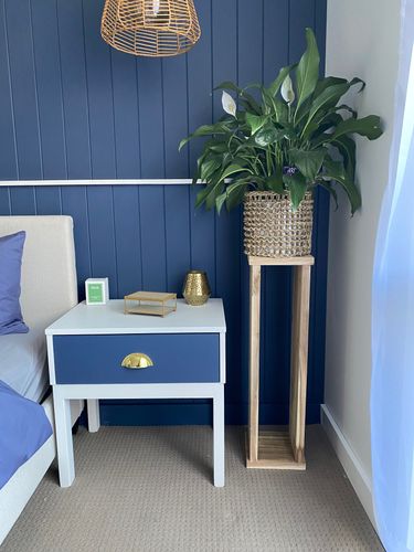

✅ Painted the bedside tables to match the wall (Porters Paints Yacht Race and Rubble)
✅ A beautiful illustration print from Aussie Posters of Bells Beach in a Kmart frame

✅ Plus the making of the plant stand and the plant pot cover
