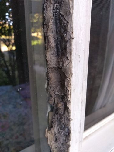

I have been painting my house during lockdowns and have achieved a lot. I now need to paint windows exposed to the weather and they have signs of deterioration. They don’t have to be perfect but do need to be waterproof.
I have several issues but thought I would start here.
The first photo is an example of the outside. Putty is still solid but cracked and in other places very crinkled.

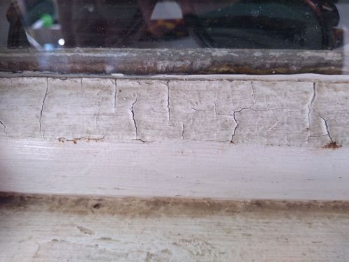

The second is inside showing water damage.
In some places putty on the outside etc is below level on inside. Could that contribute to water damage?

That exterior picture appears to illustrate a fairly standard look for aged linseed-based glazing putty. First, I believe it would be a good idea to determine if there are any water leaks. Is the timber inside the window spongy or rotted? I can see a little bit of deterioration, but that could just be the filler, and it doesn't necessarily reflect that there's a leak.
For instance, please take a look at the window putty used on the property I rent.
Someone very inexperienced has used glazing putty themselves and done a horrific job. Saying that, though, there are no leaks. The putty doesn't always need to look perfect to seal water out. If there are no leaks in your instance, you might be able to get a better look by skim coating over it without having to redo the putty completely. This would be optimal, as I must say, glazing putty is not particularly pleasant to use. It's sticky and doesn't smooth out like a cement-based filler.
You might like to start by taking a flat head screwdriver and doing a bit of exploratory work on the inside of the window. Have a little dig around those areas hard up against the glass. If that is just putty and not rotted timber, then you'll be able to sand it back and just fill the area with Earl's MulTfill Ready To Use Filler - 0.140kg White.
If there are no signs of water damage to the interior, I would suggest possibly leaving the exterior alone. If you don't like the crinkled look, you could attempt to sand it smooth and then fill over it.

I apologise. Yes, apply a skim coat (thin application) of putty over the existing putty. You could attempt to use Selleys 450g Linseed Oil Special Putty, and it would certainly be a learning experience. However, you might find that if you were to sand the crinkled window putty, it could remove most of that distortion. You'd then apply a thin application of Earl's MulTfill Ready To Use Filler - 0.140kg White over the area to fill in any cracks before painting.

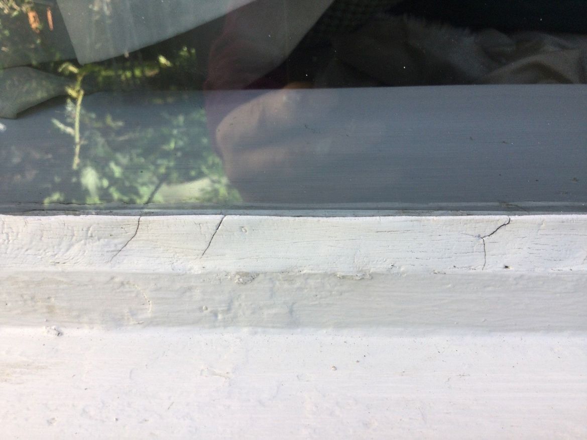

Hi I am doing a job similar to this, french doors, which have been external, however we will be installing them inside. They are a similar vintage to these pics but better condition, definitely no rot. They have been painted in an oil based paint and for ease and cost we will paint over with an oil based again, after these cosmetic repairs. I have used linseed putty before and I'm not keen to go back there in a hurry.

Do you need to redo the glazing @potteringaround? It looks quite reasonable in the image, though it might not showcase the issue.
