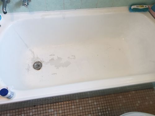

I am trying to repair an old bath tub. Its a rental property so unsure what kind of tub it is. See image. This is my first attempt so not sure how to fix the chipped of paint. Any help will be appreciated.Â
Thank you
Hello @sri1Â
Welcome to the Bunnings Workshop community. It's sensational to have you join us, and thanks for sharing your question about your bathtub.
Your first order of business is to identify if your tub is metal or plastic. I suggest getting a magnet and see if it will attach itself to the body of the tub. If the magnet attaches itself to the body of the tub, then we know it's metallic, if not then it is probably acrylic.
If you have a metallic tub which is also referred to as an enamel bath, then you can use the White Knight 500ml White Tub And Basin Paint. Please let me know which one you have.
