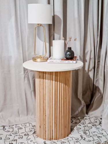

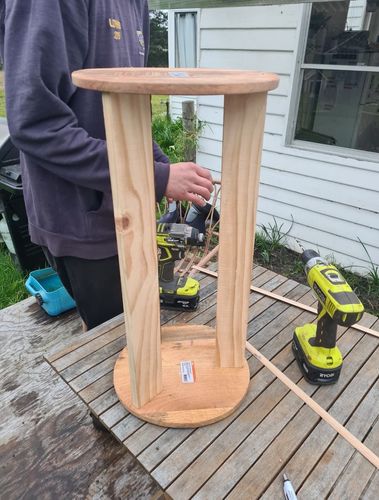

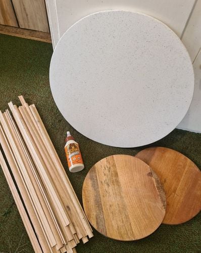

In need of a new side table I decided to get creative using some porta timber and terrazzo. For this project I used a terrazzo outdoor table from bunnings and some porta timber 18mm fly bead dowels. To create the base I used 2x round chopping boards from kmart and connected them using 3x pine to struts (cut to 600mm). I then glued the porta timber around the edge of the base using gorilla glue.
