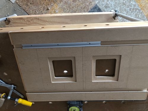

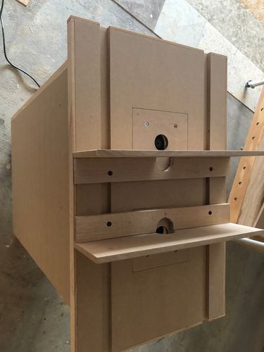

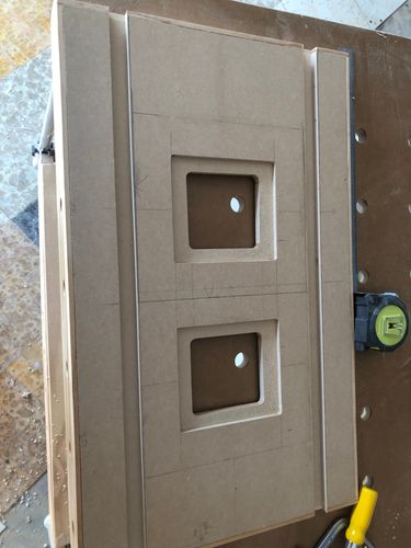

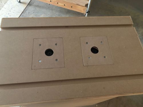

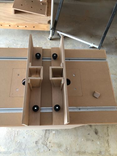

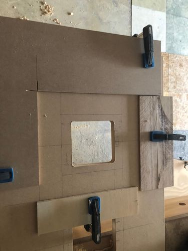

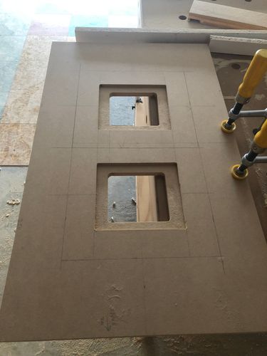

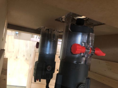

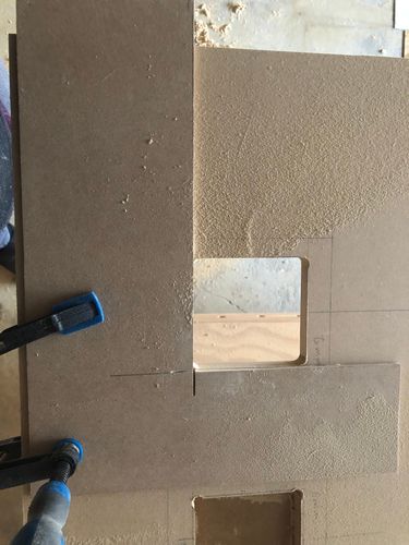

I had a a trimmer/small router fitted to a mobile cupboard, I was constantly changing router bits from straight cutting , then to a bevel router bit. I decided to modify the top of the cupboard to take two trimmers, so I can have two different types of cutters, saves a lot of time when doing woodwork projects. I used two Ozito 350W Laminate Trimmers.

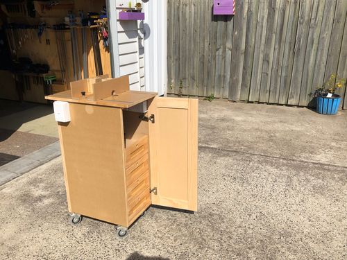

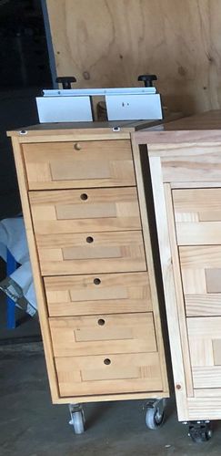

Original single unit cupboard
