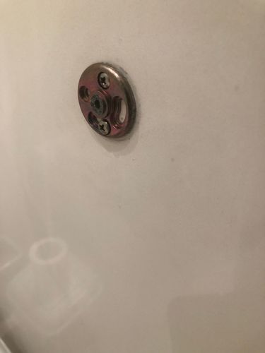

The arm broke off the toilet roll holder and the bracket on the tile will not come off. There is no hole for an Allen key or screwdriver to take it off.
How do we get the bracket off and how best to replace the arm?
@kantoon If there is no grub screw at the bottom then what you are looking at is a cover plate on top of the actual bracket. Normally just a press fit, occasionally a screw fit. Have a look on the edge for a small indent. You should be able to lever the cover off with a screw driver if press fit. Screw off with multigrips if screw fit. Once the cover is off you will be able to see the screws that hold the bracket. If you were happy with the original id suggest getting the same as you could just use the same screw holes.JDE

Hi - thanks for the advice. We managed to twist it off using a vice grip. The width of the cover is 40mm and has the attached bracket. Do we need a replacement one with the same width or can we use any size - I think the one at Bunnings is bigger at
45mm?

no luck. The screws on the bracket are too close together and won’t fit the existing holes in the tile. We need a bracket that is 3cm from the top of the top screw to the bottom of the bottom screw.

After a thorough look, the closest toilet roll holder with the same mounting dimensions is the Methven Turoa Toilet Roll Holder. I've placed a photo of its measurements below for you to have a look at. I recommend carefully opening the packaging and matching it up against your existing mounting screws. If it's compatible you can proceed to mount it on your wall. Most of the other toilet roll holder units are smaller but can be D.I.Y. modified if you have the tools to do so.
