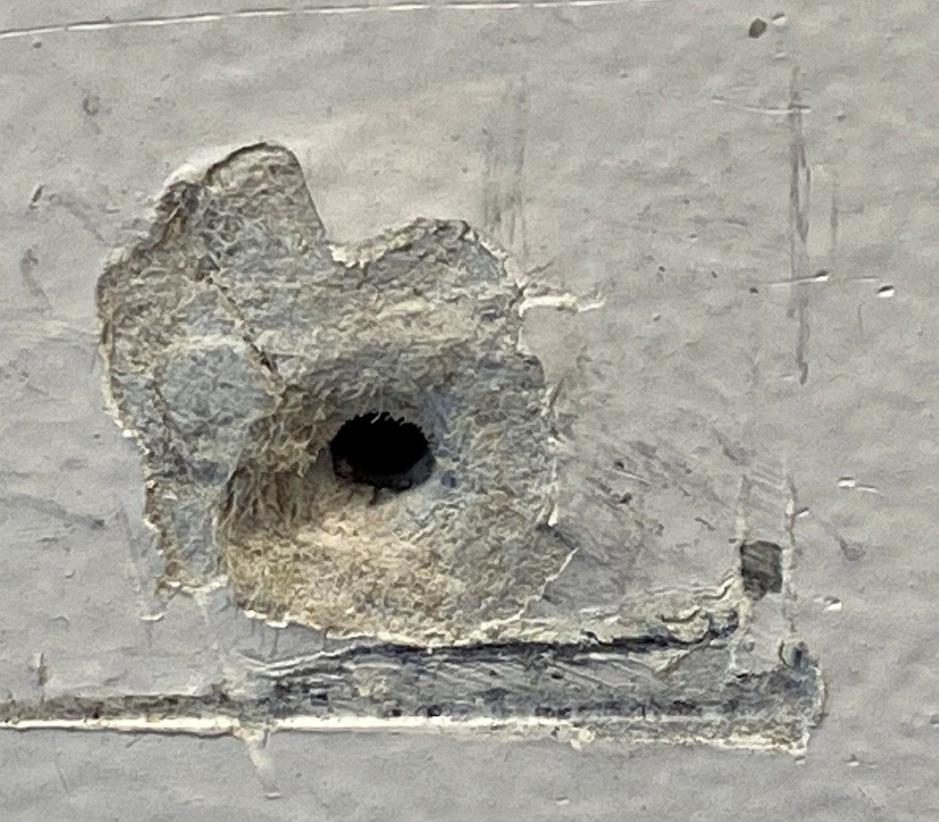

Unfortunately, your image is a tad too blurry to be able to decipher what the material is. Could you perhaps try to take another in focus one? I know it can be a little hard sometimes that close up.
Are you wanting to know if this wall lining is potentially asbestos? Houses built before 1990 are likely to contain asbestos cement products. You're kind of on the cusp there, so I wouldn't totally rule it out just to be on the safe side. However, it is almost certainly some type of cement-based water-resistant sheeting. If it's not asbestos sheeting, then it could be regular Villaboard.
If you are wanting to know if it is asbestos, the only way to be sure is to take a sample and have it tested. There are also companies that will come out and do this for you.

I was guessing that it was probably Villaboard. The bathroom was renovated about 12 years ago and the plumber, electrician and glass-wall installer DID NOT raise the possibility of asbestos. I wish I'd taken photos after the old tiles came off.
My primary reason for getting help identifying the material was to establish whether it would be a suitable material to affix the Tesa PowerKit wall mounting to
(specifically, with the Loxx Double towel rail. The websites (both Bunnings and Tesa) stress that it's not suitable for plaster or papered wall and I'm trying to establish that this is sufficiently non-absorbent for the adhesive.

What you are adhering to is a painted surface. It might be cement underneath, but it's top coated with paint. It would be a good move to lightly sand the portion of paint where the adhesive is placed to ensure it has something to bind to. Often bathroom paints have a higher sheen level, and I'm concerned that might put them in the "surfaces with a non-stick coating" category.

I hope this image is of better quality.
Wow, you certainly stepped up the game on that image, @ProfHenry. Did you get the microscope out?
As mentioned previously, it's a painted surface, and after further consideration, I wouldn't advise attaching this style of stick-on rail to it. You are glueing onto this paint, so if the paint can't hold the weight of your towels, it will pull off the wall. It's one thing to hold the weight of the rail, but if a child were to pull on a towel or an adult lean on the rail, the paint wouldn't be able to hold that additional weight. This is potentially why they haven't included painted surfaces on the list of suitable surfaces. Have you considered a towel rail that attaches with mechanical fixings as opposed to the adhesive variety?

Given this wall material is inclined to crumble slightly when drilled, which particular fixing would you recommend?
