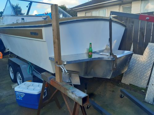

That looks like a fantastic project @tom2!
Perhaps you might like to fill our members in on some of the details about it. I'm sure some of the uninitiated will be wondering what a boat transomĀ is. We have a few keen metalworkers that I trust would like to know the specifics as well.
Many thanks for sharing.
Cheers Mitchell, the transom is the aluminium section I am adding to the back of this boat, The original back was designed for an inboard motor, I decided to put a 200HP Merc on the back that will bolt to this Frame.
Due to bing in Sth Auckland, I am not able to finish the project off, !) I have a Bunnings Argon bottle I can't re-fill...2) I'm not an essential worker to get it filled elsewhere.
Thanks for the interest Nitchell.
