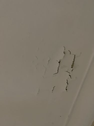

I have paint peeling for a small corner of the ceiling in the living area and in bedroom. Rest of the area seems to be fine. Any suggestions? Thanks

There is always an underlying cause as to why ceiling paint peels off from your ceiling. I suggest getting a ladder to test if the ceiling gib panel has gone soft. Push the peeled area with your finger and see if the panel is soft. If it is, odds are there is currently a leak coming from your roof and water is settling in that part of your ceiling. the leak must be repaired before you fix the ceiling paint.
However, if the panel is stiff and strong it's probably moisture damage on the paint, it has gone off and must be replaced. I suggest getting a scraper such as the Craftright 5-in-1 Scraper. This scraper is a multifunction tool and will allow you to get into tight spaces. I recommend using Crommelin 1L Flat Aquablock Waterproof Primer Undercoat to provide you with a superior primer that will seal against moisture. I propose using Dulux Ceiling White Paint as the base coat for your ceiling.
