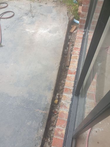

Cutting the concrete back and adding a strip drain will certainly help divert any surface water that is running towards the house wall away from it @Benk. Do you have any idea where the water is coming from? If the rain is saturating the soil surrounding the house, hitting a clay layer, and they traversing across it under your house, the strip drains won't solve that. You need to dig a trench that runs parallel to your walls down to the same level as under your house. An agline would then be installed at that depth and the trench backfilled with aggregate. That way, any water traversing under the soil will hit the aggregate and fall into the agline, which will transfer it to the stormwater lines.

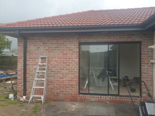

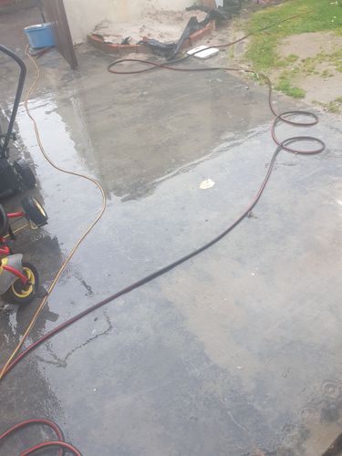

Hi All sorry missed dsome crucial information on my post.
I would like to install a drain betwwen the slab and the house to prevent water ingress under my house. Currently i have some water under the house which is concerning.
My initial thoughts was to cut the concrete so that i have a wider space then install some kind of drain to run the water into the storm drain. Then later put decking and pagola over the slab area to prevent more water getting tonthe slab in the first place.
Tge question is what kind of syatem would be best to achieve this. Thanks

Welcome to the Bunnings Workshop community @Benk. It's great to have you join us, and many thanks for your questions about solving drainage issues.
If you were to provide some information about the issue you are trying to solve, our helpful members would have an idea of how to assist. From your images, I can't identify any obvious drainage issues. Do you want to install a drainage line between your house and the concrete slab to prevent water ingress to the foundation?
