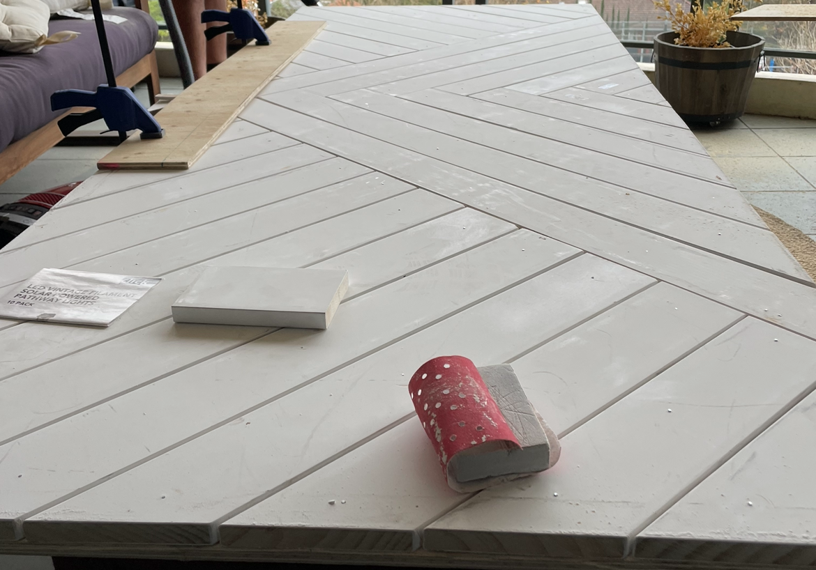

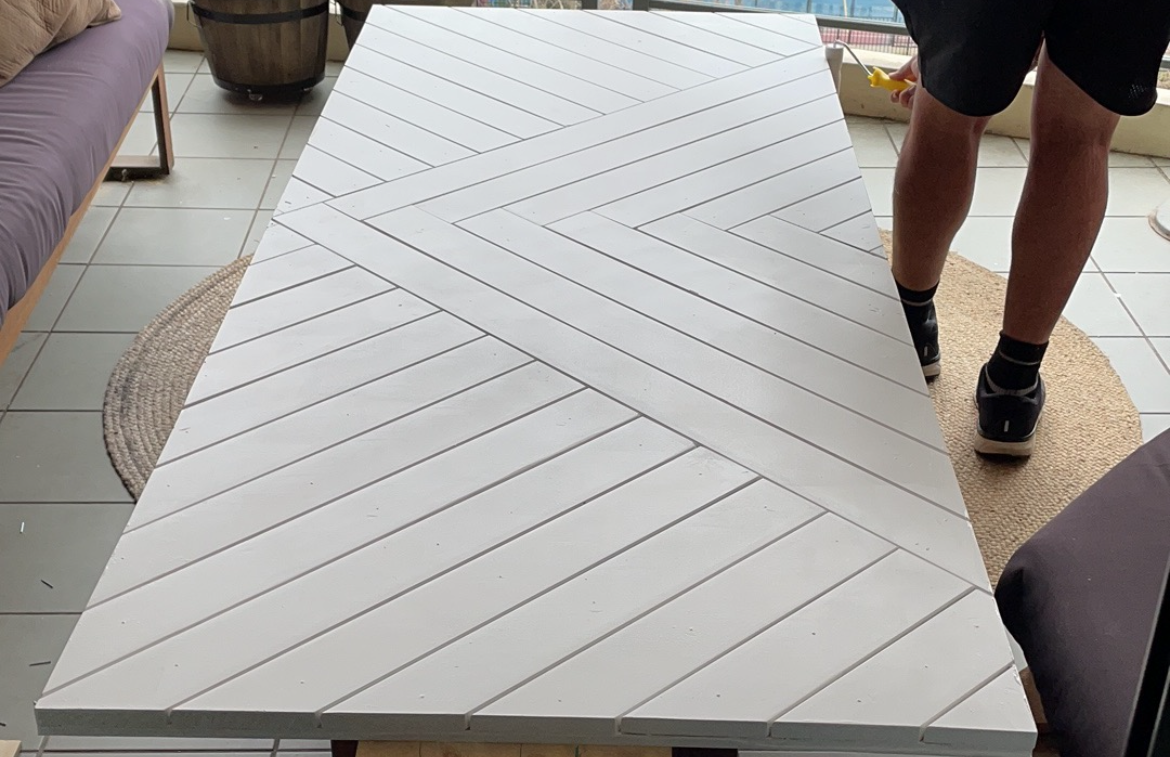

We purchased 12mm plywood for the base and white Primed Pine DAR to create a pattern for the front of the barn door. The materials cost under $350.
Word of advice, check the weight of all your materials. I had the fun job of weighing my door on scales. The only hard part of the build was cutting the door to size.

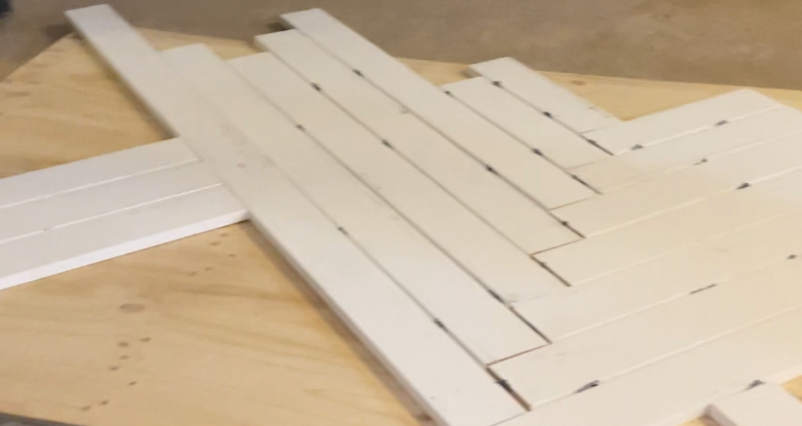

I couldn't find tile spacers to make sure the herringbone panels were evenly spaced so I used puzzle pieces.
Once that was all done, we painted the door with leftover paint we had lying around, and installed the handles and the Rolltrak pieces on the door.

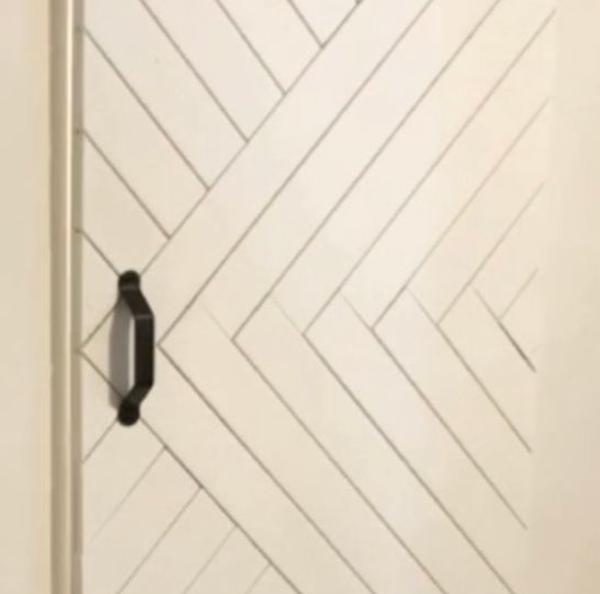

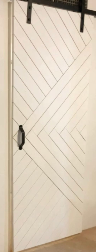

Workshop member LePallet created a diagonal design on this barn door by cutting and aligning MDF pieces.

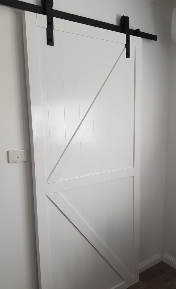

Workshop member peta shared these beautiful barn doors built by her husband.
