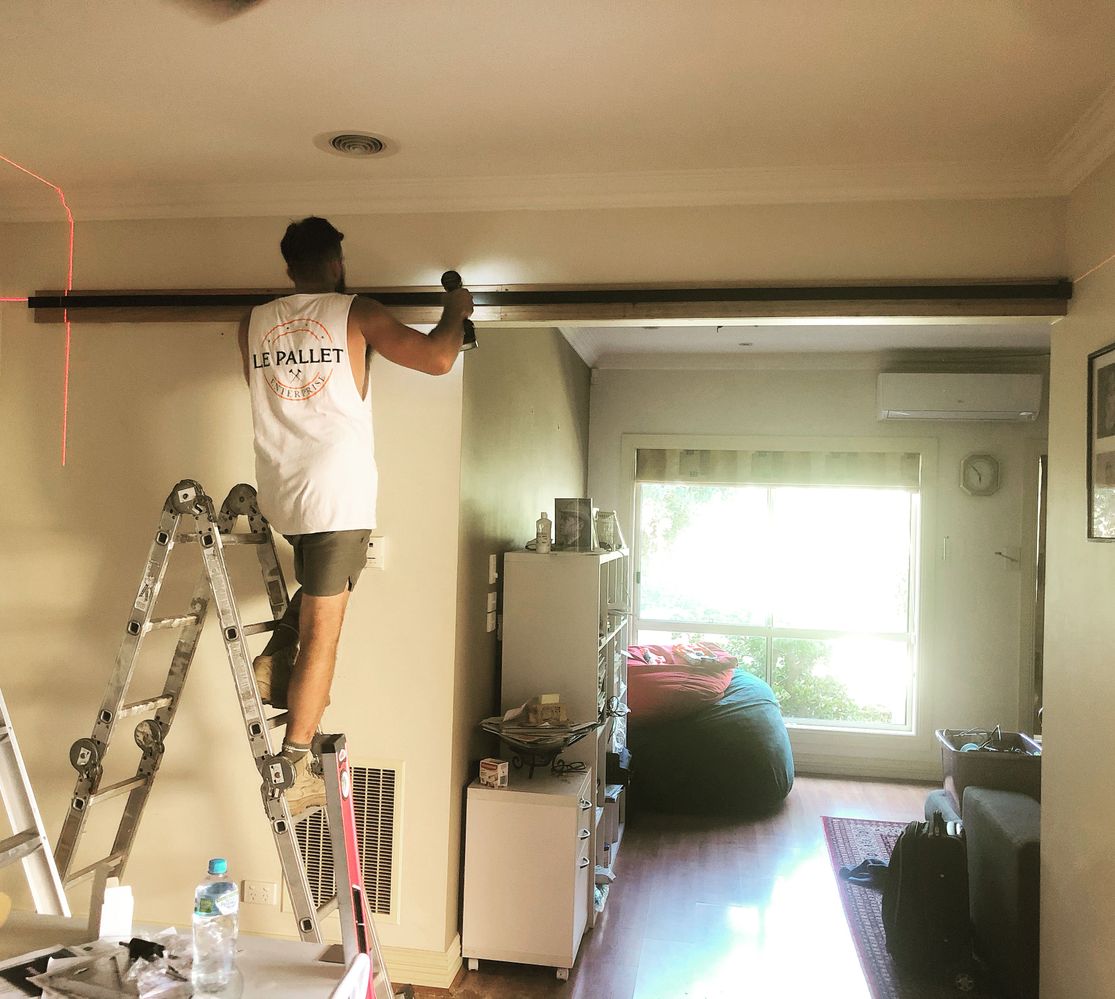

Hanging the tracks is not as complex as it looks once you know the heights and measurements. For this space, the door needed to be in one piece as there is only one way to slide. I made two doors and then joined them from the back when I hung them so they slide as one door. The door is 2.3m high and 2.0m wide.

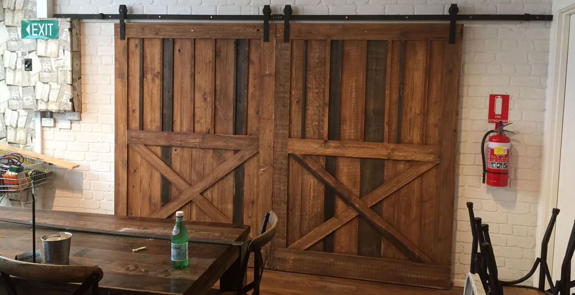

Riley also made this barn door and created a diagonal design by cutting and aligning MDF pieces.
Workshop member GeoffB built these barn doors for a cafe to screen an unused entrance and create a rustic feature.
